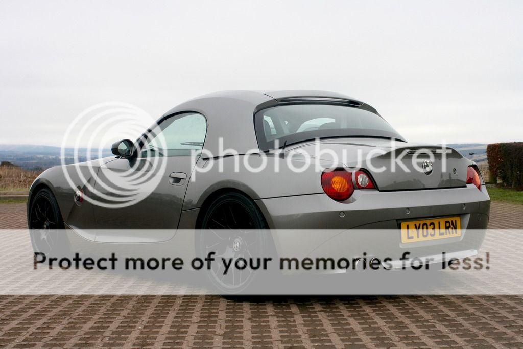

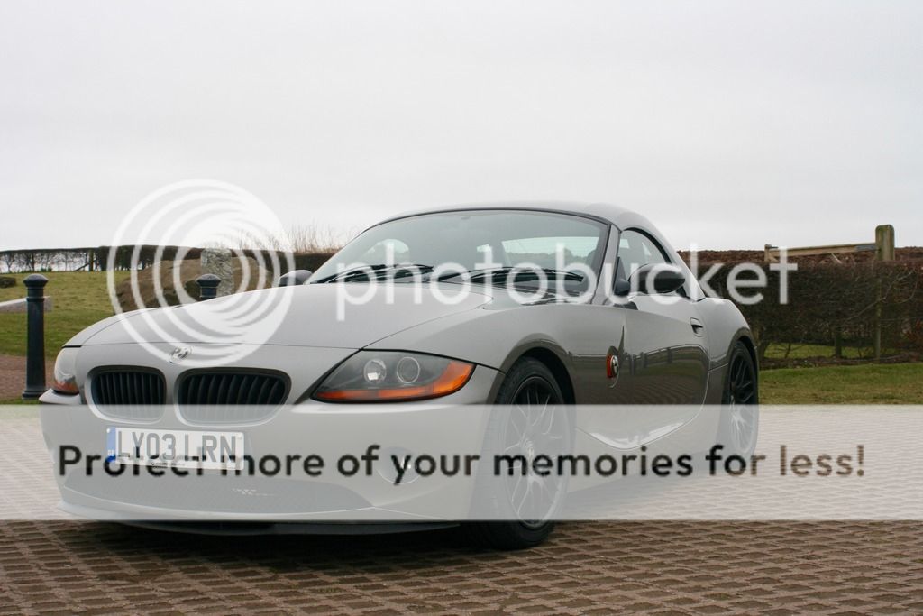

Hi there, I am a new register to the forum although I have been using it since I got my Z just under a year ago. I must say you are all a very Knowledgable bunch and have picked up some really great info.
So anyway lets get started. I have a 2003 2.5i Z4 I bought the car in june 2013 as unmodified with 50k on the clock.
Then the mods began
Wheels: RIVa DTM 18's black with 255 rears and 225 fronts. Big rears was a massive improvement not only that they fill the arches a lot better but in the rain there is so much more grip back there.
Next up was a AFE intake, this was expensive but worth it to be honest and a new exhaust, built by Stainless creations really great guys and then got 3.0 injectors fitted with a remap car now makes 225bhp and 265nM
so not far from the 3 liter
I also picked up a hard top same colour as the car, and the z4M front strut brace, and fitted the cruise control unit... best thing you can do to your car for £60.
So after all this I managed to get my car on track a couple of weeks ago with track day scotland round knockhil. Really great day only problem i found with the Z is BRAKES
So after the day I have decided I am going to do the E46 big brake conversion, front and rear (325mm fronts and 320mm rears)
I have already picked up some new disks and pads and got some callipers front and rear from an e46 330ci so stay tuned for the progress. It sounds like the rear handbrake sounds a bit of a hassle but me and my pal who is frankly a mechanical wizard have a couple of ideas.
