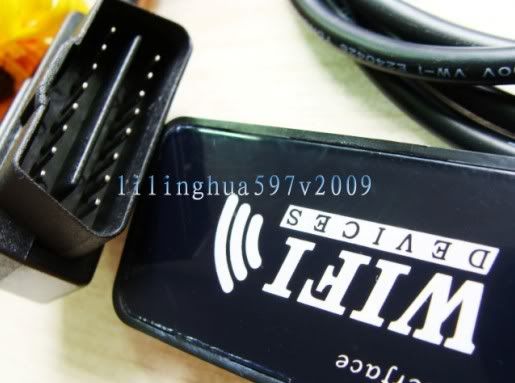

i got word about this iphone app called 'Rev' in which it allows the iphone to wireless-ly communicate with your car. you need one piece of hardware... an OBD2 wireless transmitter.
the link to the proper site is: http://www.devtoaster.com/products/rev/index.html
it has links to directly purchase the needed hardware so that you car can talk to your iphone (or itouch).
for those people that do not have an iphone, there are programs for your computer.
check it out.. do research, whatever..... i highly suggest every z4 owner outfit their vehicle with one.
here are some pics...
i have it connected and i tied it together with a twisty tie. i'm currently looking to see if i can place it somewhere efficient. it comes with an on-off switch, too, so i just leave it dangling there all the time.
this is what it looks like with the phone upright.
bottom right - Engine Coolant Temp
upper right - Engine Load (%)
lower left - Air Intake Temp
upper left - Speedo w/ 0-60 timer
MIDDLE - Real-time fuel consumption

Mr Whippy, refresh rate is realtime. No slowdown whatsoever. It also has an ecu moniter to check all a systems. And it reads and resets check engine codes.
The metrics I have shown are not the only ones. You can choose which ones you want to monitor.

Mr Whippy, unfortunately, I don't know how to record video from the phone and the app, so I can't post anything of the sort.
Peddy....
I got the PLX Devices wifi hardware. It coated me like 150. Plus they are located a few miles away. I waned the smaller key-looking one but it was too expensive.
Peddy....
