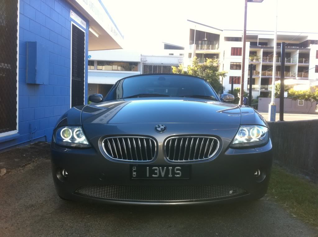

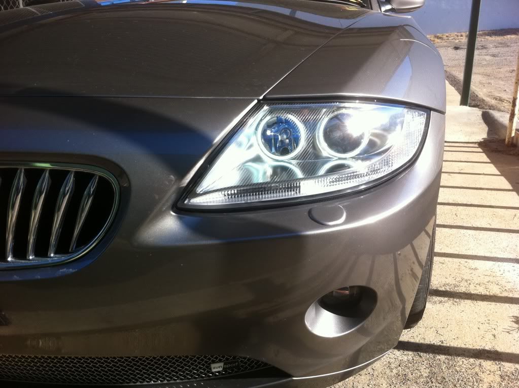

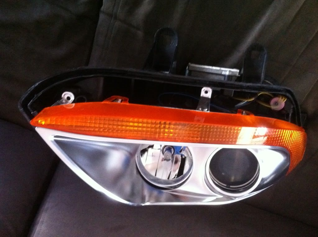

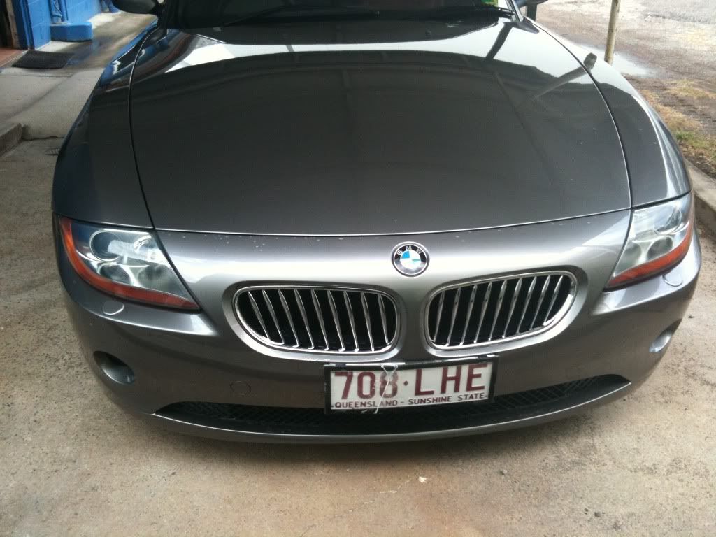

Well after a very very long weekend with a dremel and a couple of sets of headlights, I have finally joined the Angel Eyes club!! and managed to finish de-gingering my car while I was at it.
I used two sets and went the full CJ method more or less, by saving one lens and cutting the other my lights fit together like OEM. However I attached both Angel Eye's to the front cover not to the headlight reflectors, just to make sure I dont overheat them, as going back in would require use of the dremel again
anyways time for the pics...

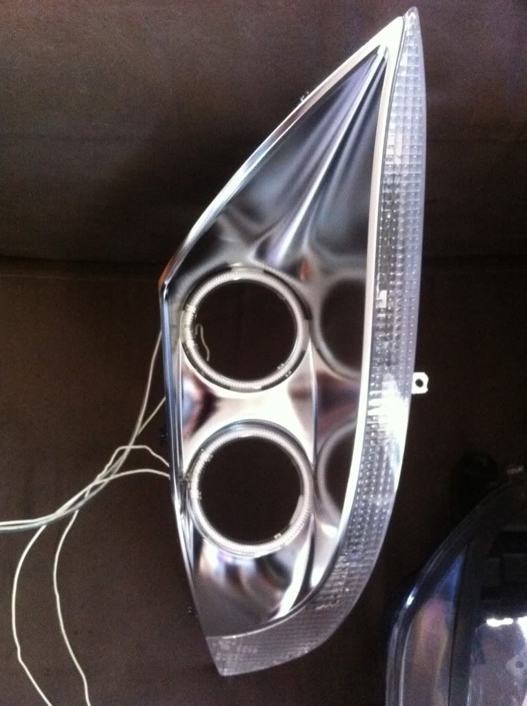

originals dis-assembled
test fitting

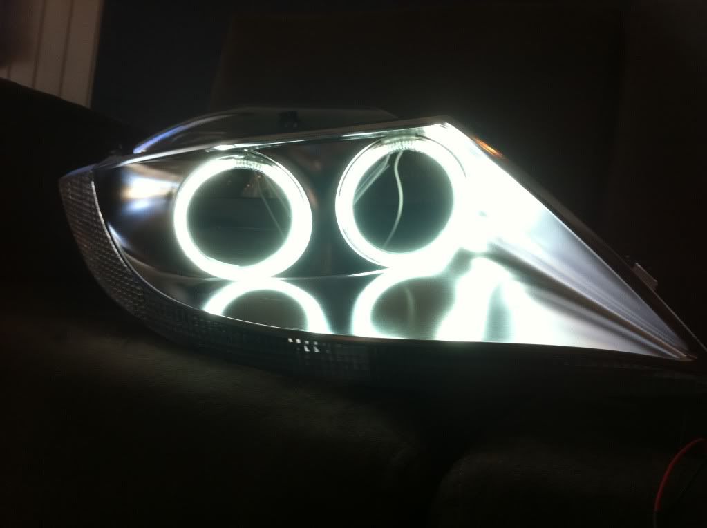

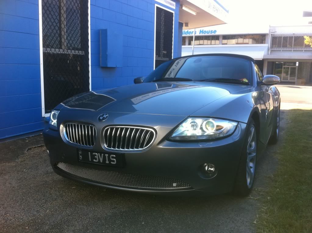

Testing they work
testing on car

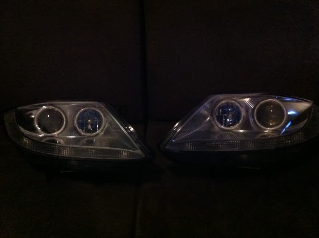

finally got em together
time to sit back and look at the car with big feeling of satisfaction

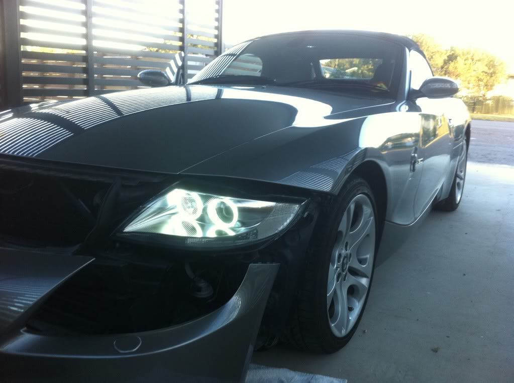

Hard to see but they are very visible in the middle of the day, will take a few more pics at dusk as the sun fades.
test fitting
Testing they work

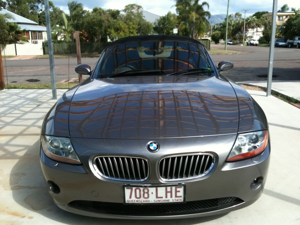

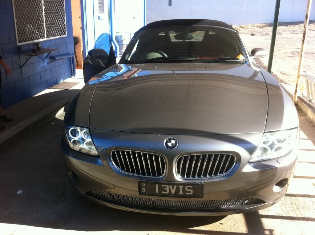

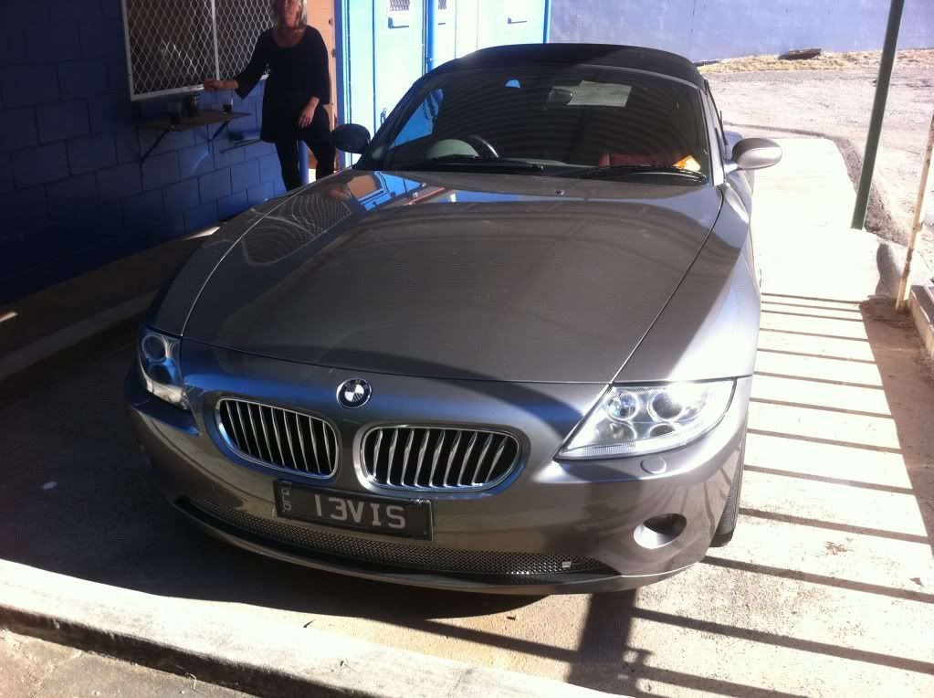

testing on car

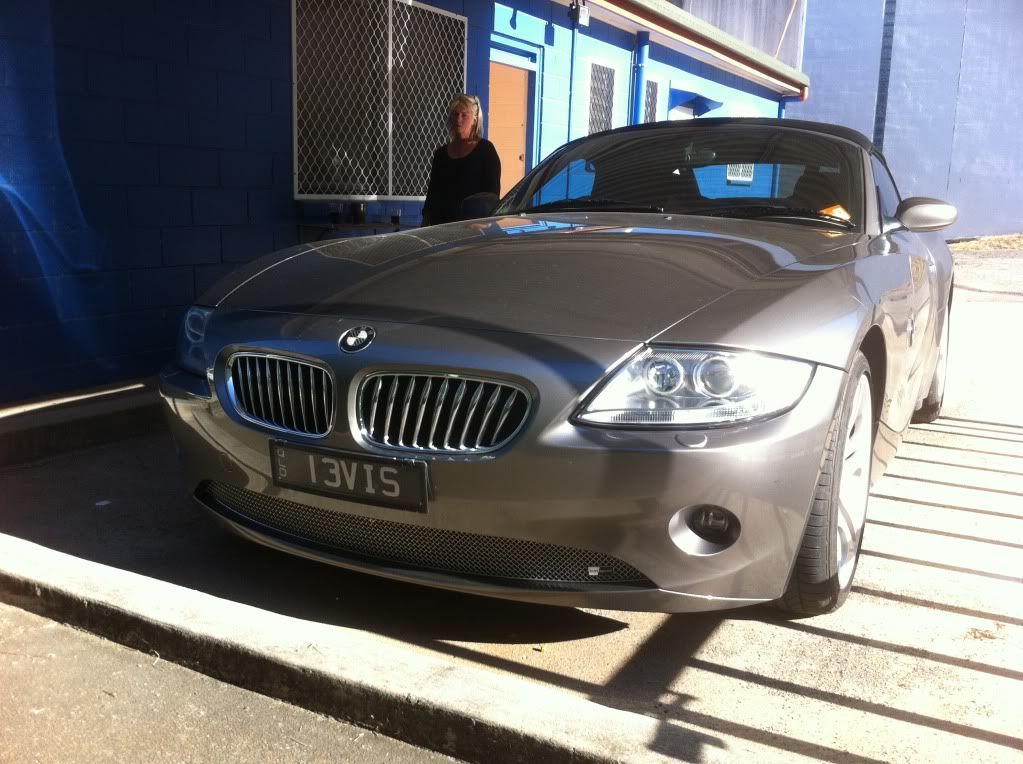

To fit the angel eyes, you need to cut the lenses off by using a dremel and cutting between the lens and black backing, takes a good 1/2 hour for each light. Then you need to clean out all the dust - which took me a good few hours with brushes/ micro fibre clothes etc.oo7ml wrote:Cool, looks very well... can someone enlighten me on what is involved to get the same on a 2008 Coupe... i thought i read before that these could be purchased and fitted easy but that does not seem to be the case above...
Next is fitting the angel eyes in place and glueing them in, then you need to mount the angel eye ballast inside the headlight and wire it into the wires inside the headlight, I used a soldering iron to ensure permanent connection. FYI the grey wire is the positive wire, and the brown wire is the negative wire. Once that is done test it and then test again to make sure it's working. Then put everything back together with a strong heatproof waterproof adhesive.
Not exactly simple, and consumed a whole weekend for me lol, see this link for some detailed instructions http://www.z4-forum.com/forum/viewtopic.php?f=2&t=2953 and good luck if you attempt it
