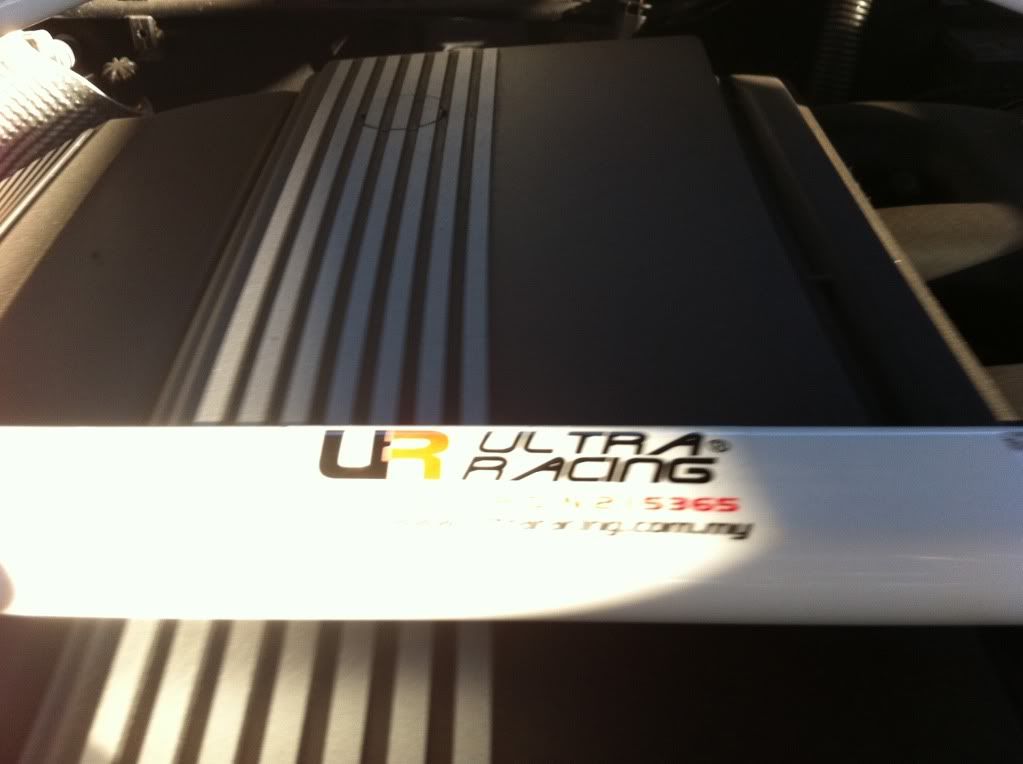

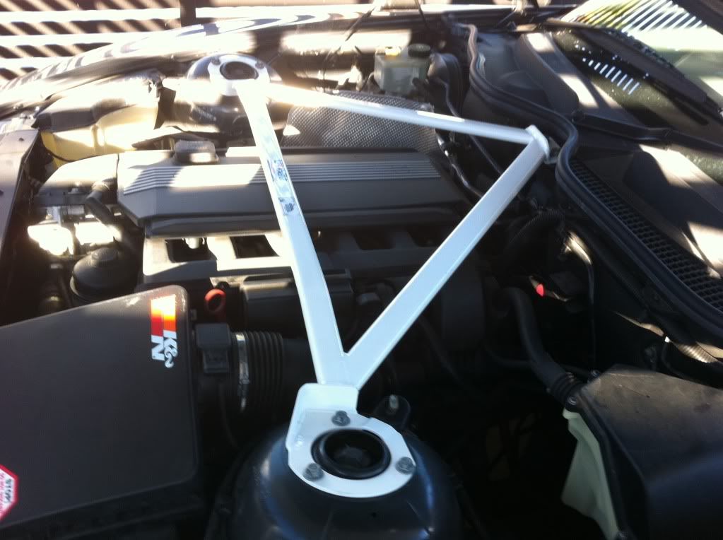

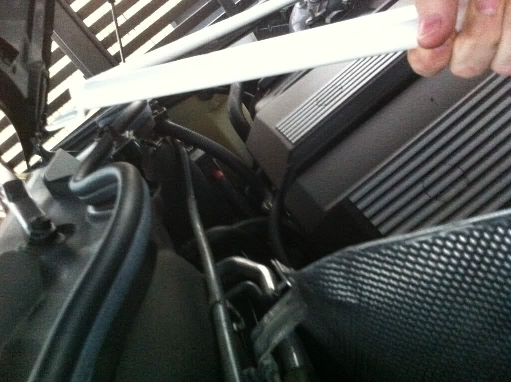

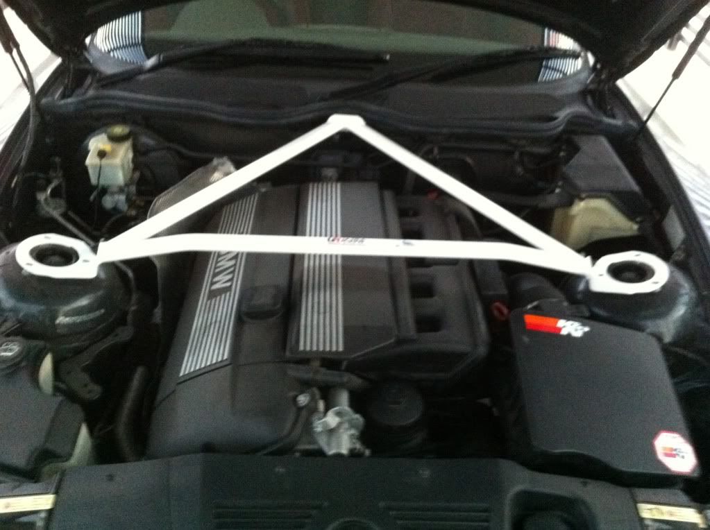

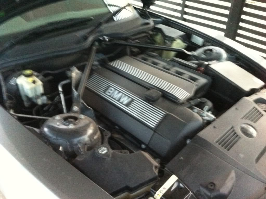

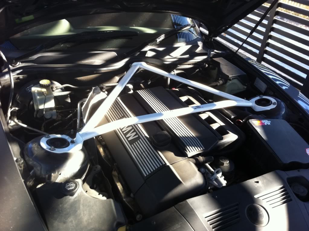

Anyways some pics of the new Brace - will take some more in the daylight tomorro
Before

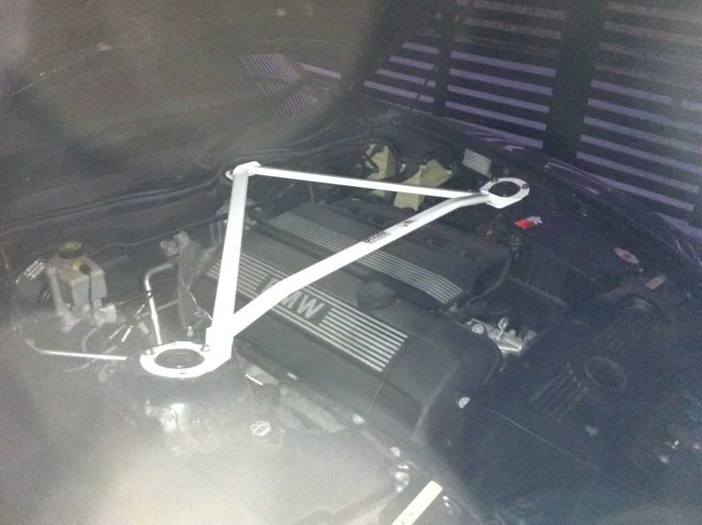

Test Fit

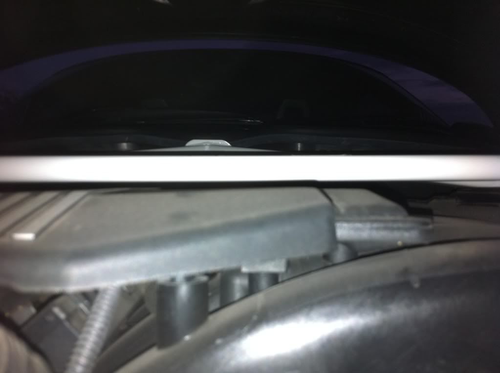

It doesnt allow for the Bonnet sensor, I have removed mine for now and will refit it later
and job done, although iphone flash is terrible

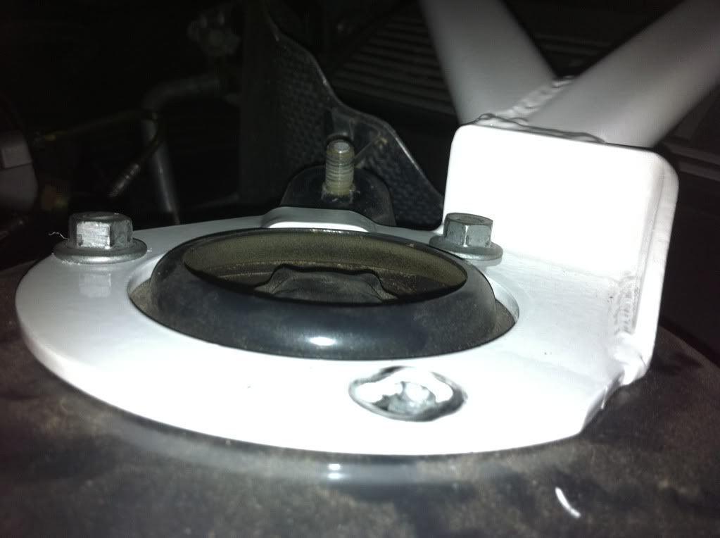

And the problem - that has me using colourfull language and dreading tomorrow
I got the old struts and bolts off fairly easily, and fitted the new brace in place, and make sure it fits. All looks good, it clears the engine by about 2cm and seems like it doesn't touch the bonnet. Finally I just had to screw the nuts on with my torque wrench set to 35NM and job done.
However this is where my problem occurred. I did up 7 of the 8 nuts without issue, then when I was doing up the last nut, I hear a loud crack and the nut comes loose. After looking at it closer it seems I have broken the thread that sticks up out of the Strut!!!!
So I'm hoping someone on hear knows something about suspension... Can I drive my car? or is it unsafe to drive while missing this nut? Also does anyone have any idea how how to fix it? or how much its gunna cost? im sure it wont be cheap - ruining what was about to be a great afternoon testing my new brace I think its part no.1 in the link below

Test Fit

well I'm pretty sure I broke it due to over-tightening, but I was using a torque wrench... the guy at the suspension shop said the BMW recommendation of 35NM is way more torque then he would ever use on one of these nuts!

As for the bonnet sensor - still not sure how I am going to get it back on, as the brace is right in the way of it mounting to the OEM location. I have been discussing with the Seller, and sent him some pics - and he said he will have his tech team look at it. They have been very helpful and responsive to my questions so far. It seems their test car, that they built the brace from didn't have a bonnet sensor so they were not aware of the issue yet.

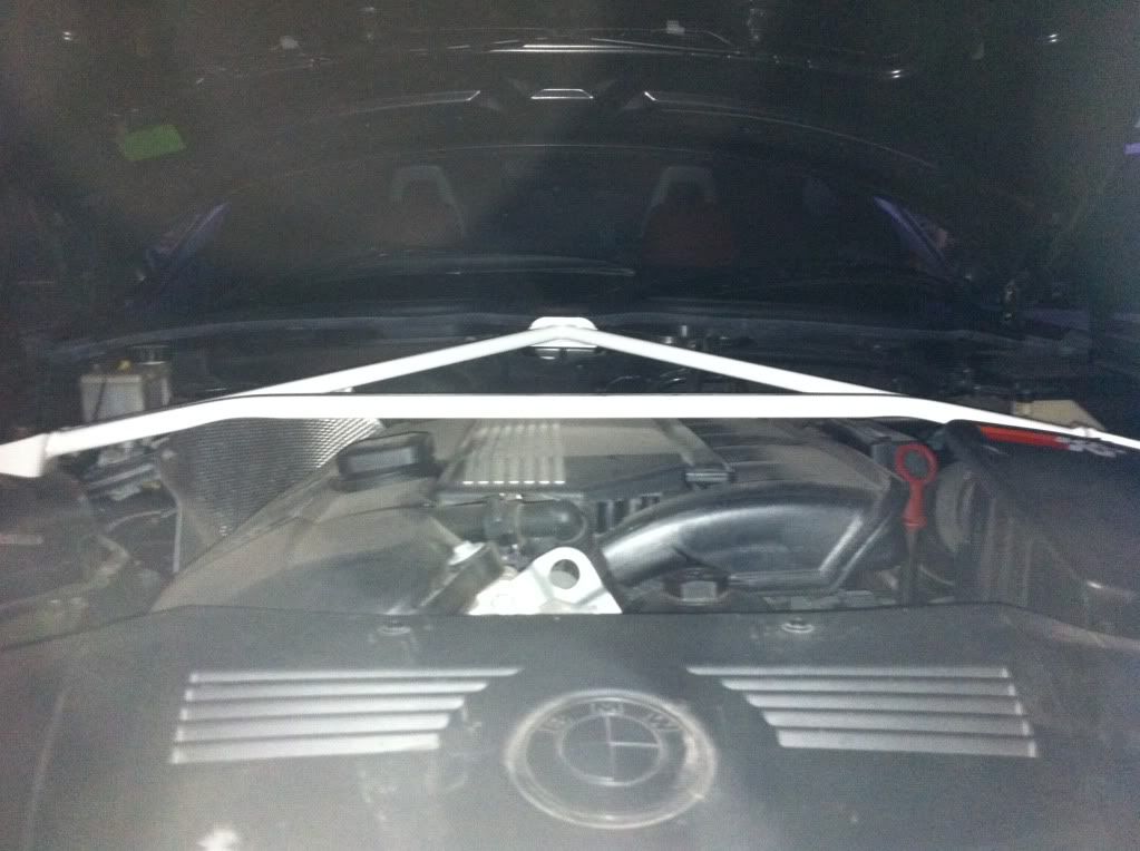

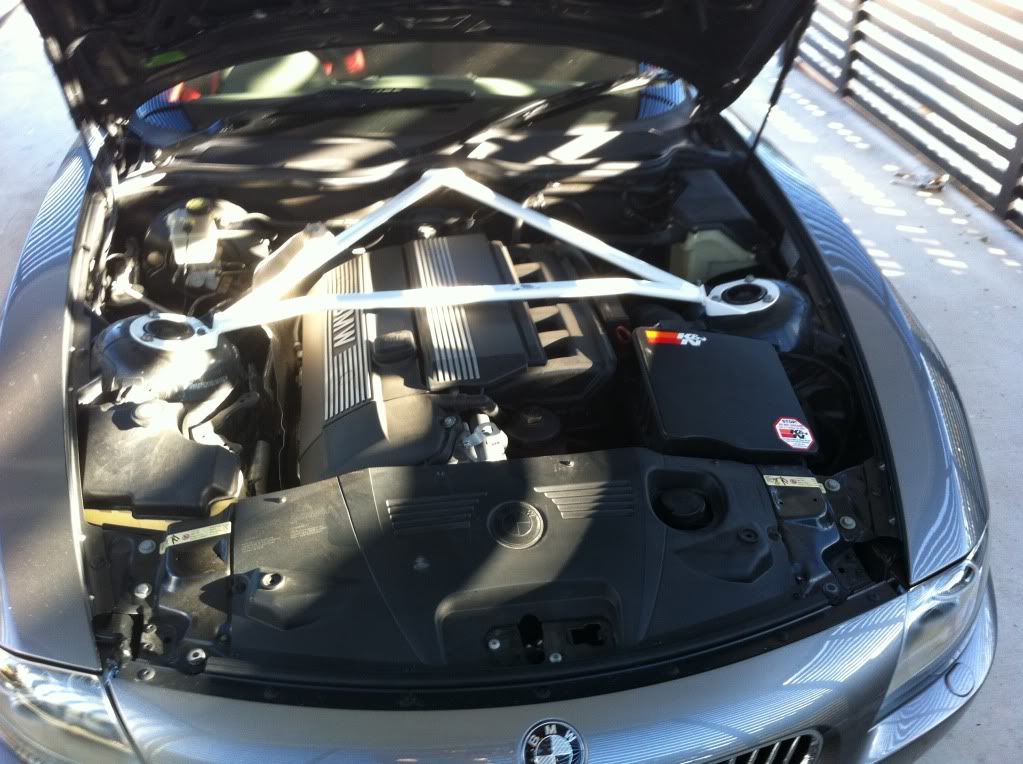

edit: Some better pics

I didn't think 35NM was that much. It's pretty crazy that you were even doing it the right way with a torque wrench and still broke it! Certainly would make mecautious!Hotride wrote:As for the bonnet sensor - still not sure how I am going to get it back on, as the brace is right in the way of it mounting to the OEM location. I have been discussing with the Seller, and sent him some pics - and he said he will have his tech team look at it. They have been very helpful and responsive to my questions so far. It seems their test car, that they built the brace from didn't have a bonnet sensor so they were not aware of the issue yet.

Ah, sorry mate, I did this - although I don't think we are alone! Mine was a torque wrench fail, I think. Glad you got it sorted though. I did think that I posted about my fiasco on here though?Hotride wrote:well after all the helpful posts I received on this...

Well my torque wrench was actually brand new, I got it that day - maybe the wrench was faulty or maybe it was just human error. Either way taught me a lesson lol.PawnSacrifice wrote:Ah, sorry mate, I did this - although I don't think we are alone! Mine was a torque wrench fail, I think. Glad you got it sorted though. I did think that I posted about my fiasco on here though?Hotride wrote:well after all the helpful posts I received on this...
