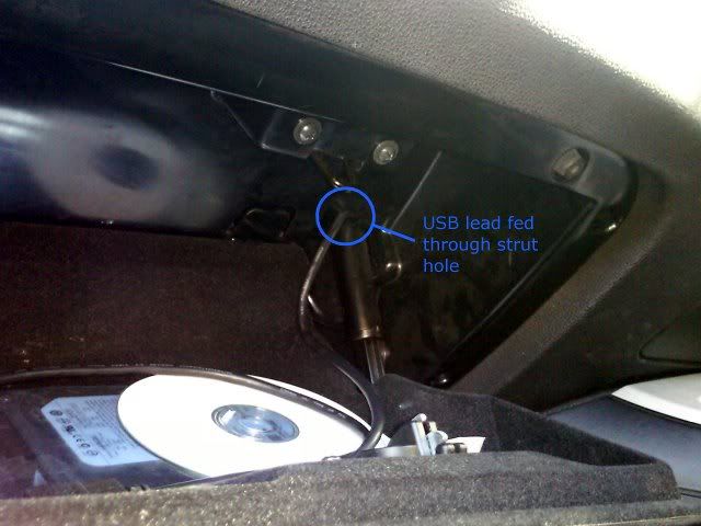

Installation was a breeze, particularly since I was familiar with the head unit access procedure from installing my aux-in cable. The pack came with a simple plug and play adaptor which connects between the stereo harness and the stereo itself. I mounted the Gateway unit itself underneath the head unit (in the same spot BMW recommends placement of the OEM iPod interface). The USB extension lead into which you plug the flash drive I routed into the glovebox via the hole in the top of the glovebox where that strut looking piece is. Here's some photos of the glovebox after the install:
The installation is VERY tidy which makes me happy. Even better is the fact that I didn't even have to drill any holes!
After confirming that the Gateway was functioning I put everything back together. At this point I worked out basic navigation of the USB drive but I couldn't work out how to get text display. Although earlier versions of the Gateway 300 required you to load a special file which enabled text on BMWs, the newer units have this functionality built in. I had found descriptions of the button presses required for the text enable procedure online but still had no luck with them. So I emailed Dension technical support. I was extremely surprised to receive a reply within an hour during the weekend! They directed me to this page: http://www.dension.com/knowledge-base/i ... ware-versi which describes the same procedure as I'd read about elsewhere, but note the line which says:

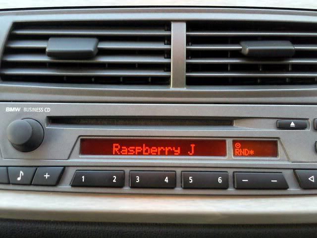

It turns out that on the Z4 the stereo display is not the default! In order to get text to show you have to select track 4 rather than track 2 when in text enable mode.
The text mode works really well! I was afraid that it might be a little laggy, but while it isn't instantaneous, the lag between pressing a button and the new text is really not noticeable. It scrolls when the track name is too long also.

ZED_NOT_ZEE wrote:I will have to try using an USB extension cable and possibly mounting the USB stick in the cubby hole between the seats.
My original plans were to do this but I decided against it for three reasons:
  1. I had heard that the USB connection can become sensitive to electrical noise when used with a longer extension than that supplied. This may be down to the quality of the extension cable though - I would ensure that you get one which is well shielded.
  2. It requires drilling holes to get the connectors through into the cubby hole (although Dension do supply a kind of snap together gland intended to fit a 20mm diameter hole).
  3. Honestly for the price of an 8GB USB drive I'm happy to take the risk of leaving it in the unlocked glovebox with the roof down (the glovebox does not lock with the car and instead requires a key).

Well it's been a week with the Gateway 300 and so far so good! I do have two main discoveries:
1. Make sure you use a quality flash drive. You would think that they're all the same, but I picked up a Sandisk Cruzer drive to dedicate to the Gateway and it made quite a difference. With the old generic brand flash drive I was using it would take about 15-20 seconds between starting the car and the music resuming (the Gateway unit would scan as if it was hunting for an input source) however with the Cruzer it's only one or two seconds. The lag between pressing a button and the new text displaying may have improved, but it wasn't exactly noticeable to begin with.
2. The BMW business CD does not lock in random mode! I generally like to have my music playing on random, which works nicely by pressing the RND button on the head unit after selecting play all (under the Track 4 GW300 menu). The problem is that after the system is turned off (i.e. when leaving the car) the head unit cancels the random function. So although the GW300 will resume playing from the spot in the track where it left off, once that track is finished it will simply play the next track in that album rather than picking a new one at random. If you want to have it continue playing at random you have to remember to hit the RND button again before the sing ends.
I've emailed Dension tech support about it but from what I've read this is simply a limitation of the BMW Business CD head unit...
Overall I'm still very happy with the unit, and the text display is still putting a smile on my face :thumbsup:
