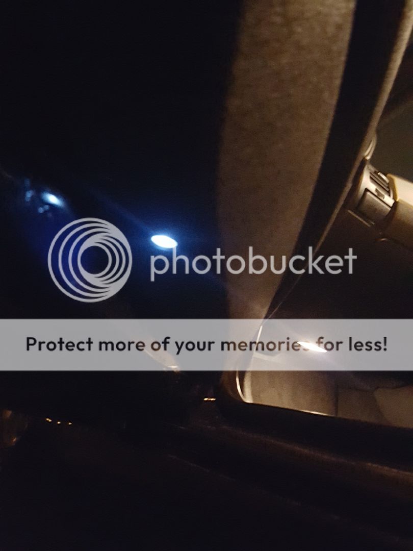

So I did a mod this weekend after viewing a few threads and figuring out how to do it. I installed BMW welcome projector lights on both doors.
The logo does look a little bit out of shape because each time I was parked half on the footpath.

How big a hole do you have to cut in the bottom of the door card ?

Thanks bud. The face of the led is 1.8cm so about that size hole. You get a hole cutter with the LEDs.Stuartt wrote:TBH I quite like them.

Rajen, I have a set of puddle lights with projectors that I plan on installing but there was no OEM wiring in the doors for them. I have looked over another DIY on installing these where they tapped into the footwell lights, did you do the same? If so, did you connect through the connector in the door? If not, how? Some pics of your wiring would be greatly appreciated.rajen44 wrote:So I did a mod this weekend after viewing a few threads and figuring out how to do it. I installed BMW welcome projector lights on both doors.

There's no existing wiring in the door for any form of auto dimming, just speakers and switched power to windows, locks, etc., so you have to put at least a single power feed into the door. I used the footwell light as it's close to the door as it's a fully controlled source to operate in conjunction with keys and ignition, plus engine starting.
Opening the door hinge and adding a new pin to each side is the neatest, but you could attach a lead underneath it

That's what I suspected and IIRC, you did the DIY write-up? My concern is the male/female pin that goes into the connector (used hole #8). I have ordered some connectors, but not certain if they are the correct size. Also, did you need to disconnect the battery to prevent the airbag light from being triggered? I believe the airbag wiring also runs through that door connection and might cause a fault when disconnected.cj10jeeper wrote:rj
I have not yet dug around for the wiring of the footwell lights but presume that to be simple and recongnizable?
