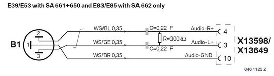

You want to get your hands on a couple 4 pin fan connectors like these, one for each row of the 12 pin connector on the back of the headunit...
Then simply extend the wires and wire them to your mini jack, configure the other end so they connect to pins 3,4 and 10 on the headunit.
I did alot of searching on this topic as my aux input didnt work on my 2007 SE. The problem wasnt with the cable, my headunit just didnt detect the signal so i couldnt select aux input, then i came across the wiring diagram for the aux input...
I had to add the 2 capacitors and resistor so i made a small extension with these and now it works perfect.
0.22 F capacitor? Is that right? Seems a tad large... and trying to find a 4-pin fan connector is proving interesting! Perhaps a floppy disk drive power connector will suffice? Looks similar size.
http://www.maplin.co.uk/module.aspx?moduleno=1319
You can use 220nF or 0.22uF capacitors. I got the info from here....
http://www.mini2.com/forum/interior-ice/166862-diy-aux-input-uk-mini-cooper-pics.html
