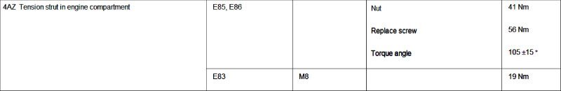

I'm finding a lot of conflicting information about how tight they should be, any input on that count? Trying to find specific information on TIS with a mobile browser is a lesson in futility!

Here it is:
