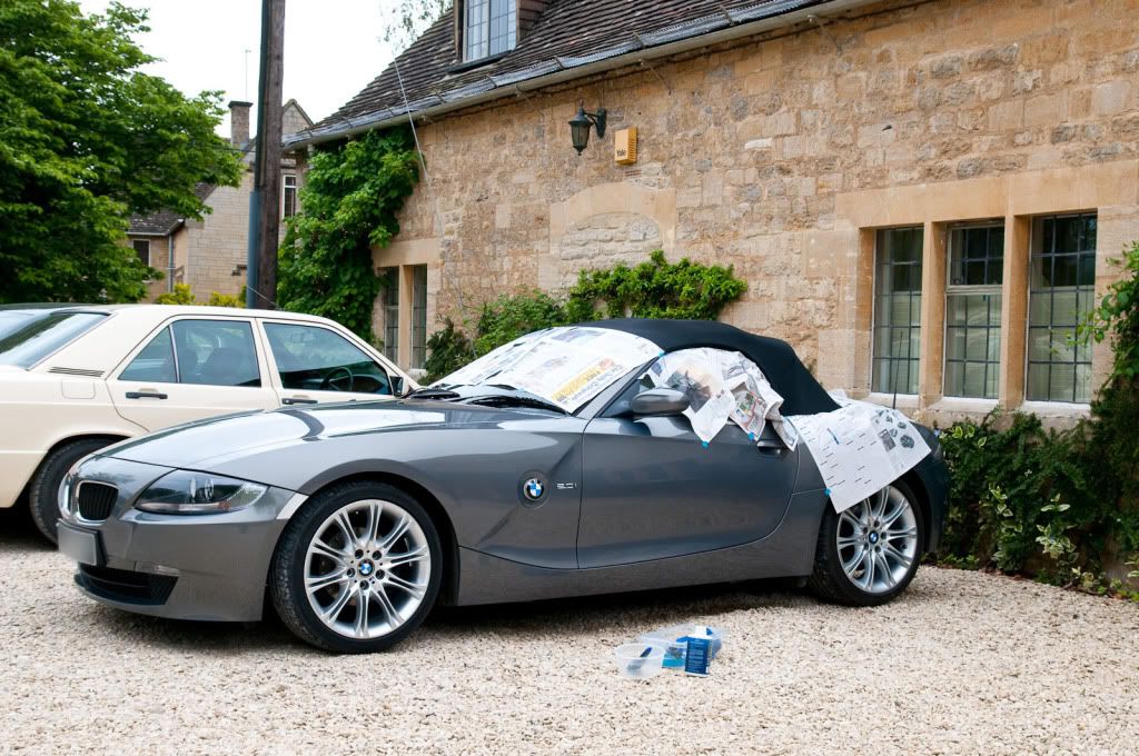

Before proofing, you need to mask off bodywork that is close to the roof. You don't want any proofer getting on your paintwork. If you're careful, you can just use a little masking tape. If this is your first time, or you're a little clumsy use masking tape and newspaper:

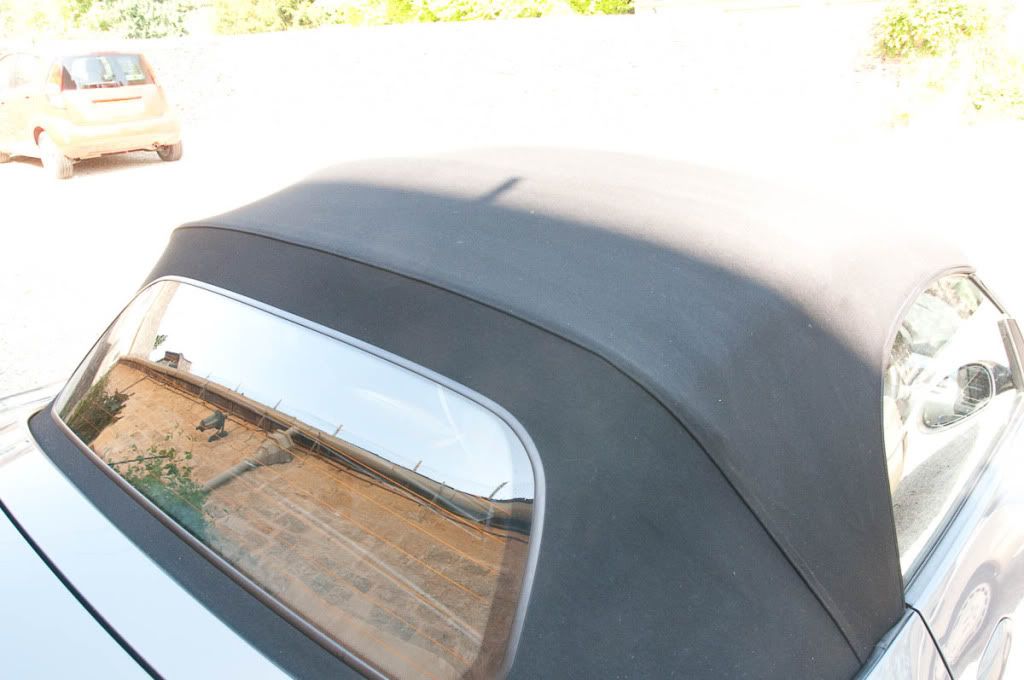

Once you're done the roof should look something like this:
Leave the roof to dry, I tend to leave it overnight. When dry it should look something like this:
Note that it appears very slightly uneven, you may notice brushstrokes or lighter areas. Do not worry, this will even out over the next few days and you'll have a fantastic looking black roof in no time:

Good write up. The first time I did mine with auto glym, I didn't mask the bodywork. But The sealant left marks, which were a bugger to get off. so The use of a bit of news paper is a good idea.
