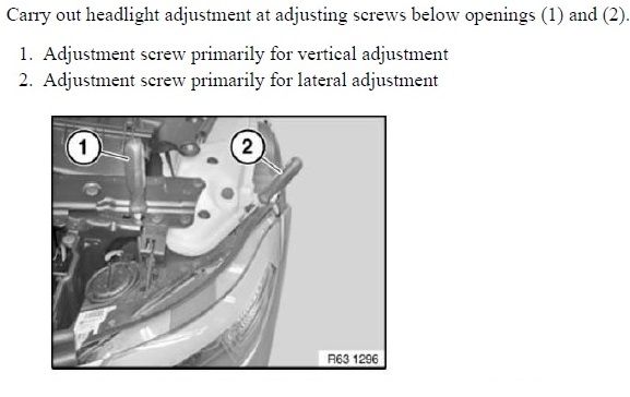

Or adjust these?MikeMG wrote:I have been able to simply fix the problem following some research on other forums. There is a sensor on the rear driver's side suspension and its mechanism can get hung up, after going over a big bump in the road, thus telling the car to dip the headlights as low as possible.

- Posts: 4045
- Location: Stourbridge
Low Beam Headlights too Low?
Yes but that pic is not the E89.
They are not that easy to get too.
- Posts: 2811
- Joined: Sun Nov 20, 2016 2:49 am
NOW I know.flybobbie wrote:Yes but that pic is not the E89.
