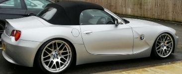

Hey guys,
I'm trying to decide which csl to go for on my coupe si
I've decided between these two from cmwheels and bmautosport however rears for bmauto are different being et45 instead of et40 from cmwheels. what does that mean ?
once wheelks are on id like to add lowering springs without having scarping arches or rolling them.
are quality on both of these similar
http://www.bmautosport.co.uk/showroom/p ... 134_46_298
http://www.cmwheels.com/index.php?route ... ct_id=1219
Thanks!

PM either "jamiez4" or "z4pilot" who bought Jamie's CSL reps
Both were fitted on Si coupes , what is most critical to avoid the arch rub is go 225 35 on the front tyre as opposed to 235 35
Pic here of z4pilots Montego blue car (has been lowered ) on 19inch CSL reps :thumbsup:

235 seems fine on mine without lowering on the front! but you do plan to lower so go with 225.

I've got ET38 on 8.5j on the front, the same as the Atomics you're looking at. I run 235/35/19, lowered on Eibachs and there's no rubbing. 225/35/19 looked a little too stretched for my personal preference.

mr wilks wrote:PM either "jamiez4" or "z4pilot" who bought Jamie's CSL reps
Yep, I can confirm that on Eibach's I got a fair bit of rubbing with 235 tyres, so switched to 225. StigJ also runs 225 on 8.5 width fronts - they are very slightly stretched, but it's not very noticeable. It stopped 99% of the rubbing, although I do get a tiny bit on sharp dips - the sort where there's been subsidence of the road surface. Specs on the wheels are; Atomic CSL reps, 8.5 ET 38 fronts, 9.5 ET33 rears. Rears are very flush with the arches, but I've no rubbing whatsoever at the back. Quality of the wheels seems pretty good - no issues with the paint quality.
