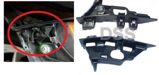

- Posts: 2

- Posts: 2
- Joined: Thu Jan 28, 2016 3:22 pm
[HowTo] Front Bumper & Headlight Removal - Z4 E85
Ducklakeview i found this parts wit the OEM numbers you gave me but i think they`re not the same, or are they?
- 69526314Visduct.jpg (88.76 KiB) Viewed 14725 times
About £25 pounds each from my local dealer but a real pain to remove the old ones.
They are the correct part No's from Real OEM.
