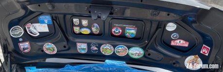

My favorite memories by car were the trips through the Alps: Stelvio Pass, Furka Pass, Pordoi Pass, Bernina Pass and the others that you can see in the second picture with the stickers :)
