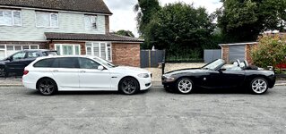

So far I have loved every minute of driving it and as it's my second car and project one at that it doesn't get driven every day as I have a BMW 5Series Touring as my daily.
The two together.
