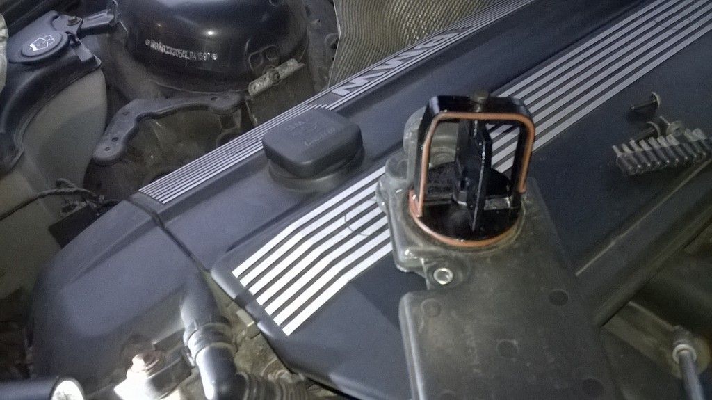

Few issues i needed to get sorted:
Air Filter: Replaced
Oil Filter & Oil will be done next weekend.
Cabin Filter: Replaced
Check DISA: All ok
Serpentine Belt showing signs of cracking: Now replaced (not has hard as i thought it would be)
Lower Intake Boot Damaged: Now Replaced
Hood Sump Drain: Now cleaned, cleared blockage and inserted flexy rod up into sump to check for blockage at sump end. (hope i managed to get through into sump area but it is just a pity you cant look inside without removing hood.
Wiper Motor Sump: previous owner reported sometimes carpet was wet on passenger side, i am wondering if this was the issue.
BEFORE
AFTER
Coolant Expansion Tank: This was split down one side and needed to be replaced.
I am not going to say it was an easy job :-( i do believe some are but not this one.
So that is belt, tank and intake boot replaced today, i am pretty sure i took out about 3 ltrs of coolant but only 2 lltr has gone back in? am i missing something?
Appreciate any comments and advise.
If you took out 3l of coolant but only got 2l back in you probably have an air lock. Not sure how to clear this on the Zed but on previous cars I find squezing the hose into the rad with engine running will usually clear an air lock. There may well be a bleed screw somewhere on these cars as well.
Nice work B7evan - impressive and great to have photos :thumbsup:
Can't help with the coolant but there must be a way to bleed the system - anyone know? :?
Cheers guys, yes a few days of squeezing hoses and bleeding tank finally got another litre or so back in. :thumbsup:
