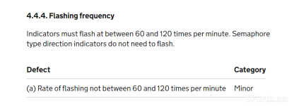

Unless it's changed recently the fast flashing will be a minor, my car has this in its mot history. And my car had tape over the bulb out and airbag light which I didn't know about until scanning the car, both faults were caused by corroded connectors in the headlight and the passenger seat connector, and the car passed one mot with the bulb issue and at least two with the airbag one, I found it a year after owning the car
