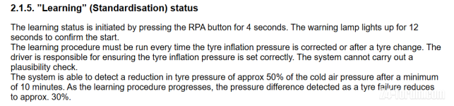

Hot on the heels of another thread saying how great we are at answering questions, I have one today. I am in Spain in the ZM. It’s hot; about 37 degrees. While out today and on a terrible road (but not as terrible as the one I tried earlier which went from a proper B Road to a completely destroyed two laner (think Africa). We had to turn back - and this was the main road into the area). Anyway I digress. Short story is the Red Flat Tyre binged into life. Stopped. Checked tyres - remember not run flats. Okay. Carried onto next petrol station about 40 miles later - yes that uninhabited. Checked with an airline - 2.4Bar all round; maybe slightly more rear offside. About right as the tyres were hot. What’s going on please? I pressed the centre dash button to remove the light/bong when I go my to the hotel 100 miles after that.
