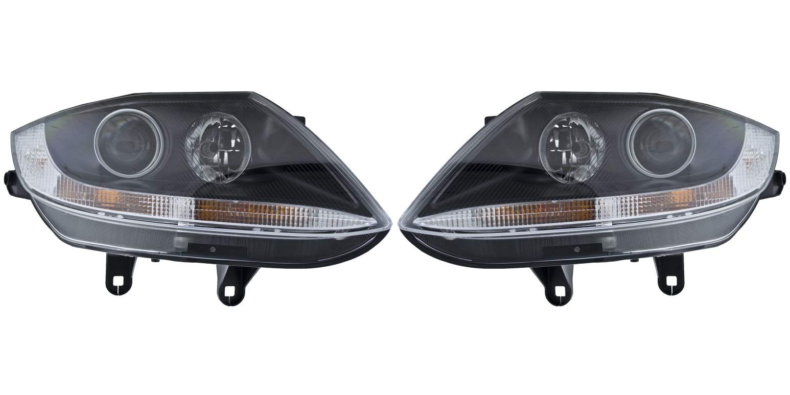

Good then, investigating how to mount restyled xenon headlights in my car, since I have a prestyled, I decided to work out how I could do it.
thanks to
The brico is valid for the entire range of headlights
Halogen headlight with orange indicator and halogen headlight with transparent indicator are the same headlight.
Prestyled or restyled halogen xenon headlights, ignore the silver background:
Pre halogen / xenon
Restyled halogen:
Bixneon restyled lighthouse, the one we are going to mount:
I put you in situation
PreRestyled headlight, with orange or transparent halogen restyled flashing stripe.
