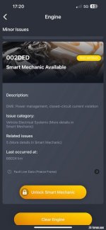

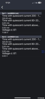

Carly on the car before I turned it off gave a 002DED error which means nothing really, its like a soft error prior to getting a warning light.
Screenshotted the error and its data which I will attach.

That error is when the DME finds a circuit that is consuming too much current in the given circumstances
Normally it’s associated with comfort access or Bluetooth type things not shutting down correctly when the car is parked
