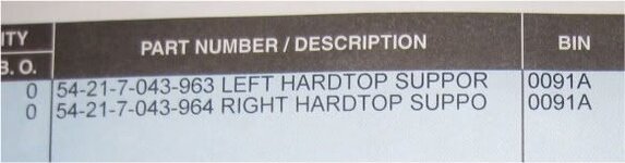

I ordered my parts from Tischer BMW’s online parts department -- www getbmwparts dot com -- for local pickup, as I live not far from their Silver Spring MD location. For reference, I’ve included Tischer’s discounted prices (as of December 2010).
A very good reference is the RealOEM Parts Diagram: http://www.realoem.com/bmw/showparts.do?model=BU33&mospid=49304&btnr=54_0330&hg=54&fg=15

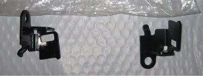

The Prep Kit. This consists of the TWO supports that must be installed on the car (one on the left, one on the right). These are listed as Item(s) # 10 in the RealOEM diagram. Once installed, the Hard Top is locked down into these two ‘receivers’ (in addition to being locked at the front header). These supports also include the electrical wiring and harnesses that must be connected to the car’s pre-existing wiring. Left Support is 54217043963, Right Support is 54217043964. $98.27 EACH. As pictured below, the Left/Driver's side Support has the Brown and Brown/Yellow stripe wires, and the Right/Passenger's side Support has the single Red/Black stripe wire. The openings (looks like two silver Cs facing each other) are where the posts from the hardtop are inserted and locked down.

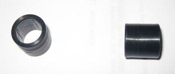

Removed, the two caps (shorting plugs) look like this:
