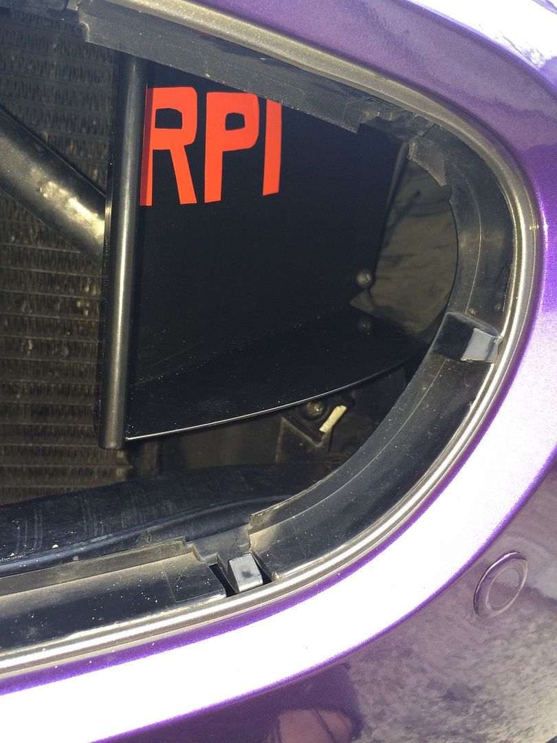

Fitted when i got home in 20 minutes. Fit is very good, as good as any aftermarket product in fact. Well done Dan, they're a credit to you hard graft mate!

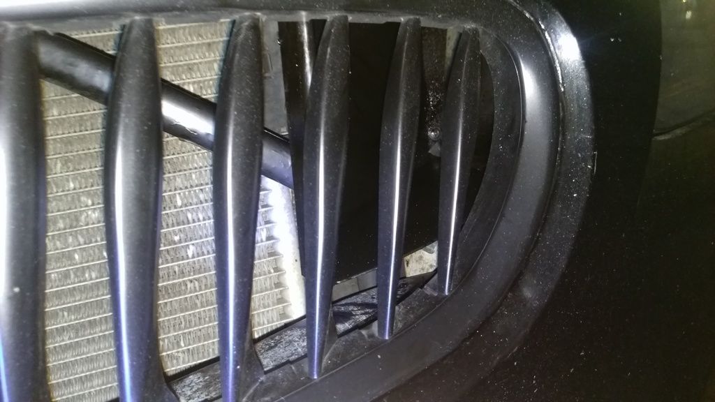

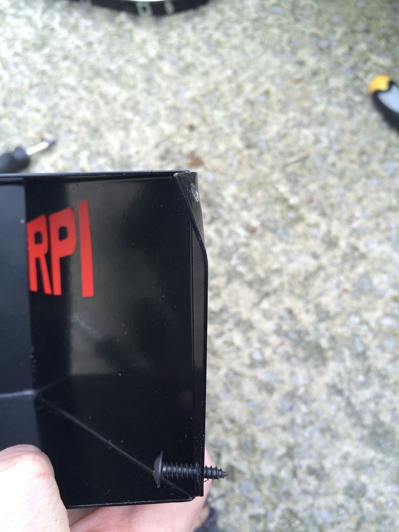

Took off kidney grill. Removed the original plastic air scoop. It's held in place with a plastic rivet. Used a pair of pliers to pull out centre pin and rivet, then pull out original scoop! Offered new scoop up! Marked top hole first! Pretty much the furthest point up on the trim in the top corner. Used small drill bit to pilot hole. You can just get it in at angle, which is ideal for getting a long Phillips in at the same angle (easier than using a stubby). Fitted the top screw, then marked up the second hole. Remove scoop, same as above for bottom hole. Re fitted scoop with both screws, bent bottom leg in to meet side plastic trim, marked up hole, removed scoop again then repeated the above. You will have to open up the holes for the supplied screws to fit or use smaller screws. I opened them up slightly as smaller screws may not be enough to support it. The fit is very good, as i said easily as good as any other aftermarket product I've fitted. Scoop is very hefty, but not heavy, and the three screws are more than enough to support it. I was surprised how rigid it was when done.
Before last fit i gave the rear of the scoop and the screw holes a blast of black Waxoil then the heads of the screws when fitted. will get out later in the week to see if i can see any difference.
15-20 minute job max with the right tools. One thing i did do was rubbed a magnet across my screwdriver to make fitting the screw on the bottom leg a lot easier!

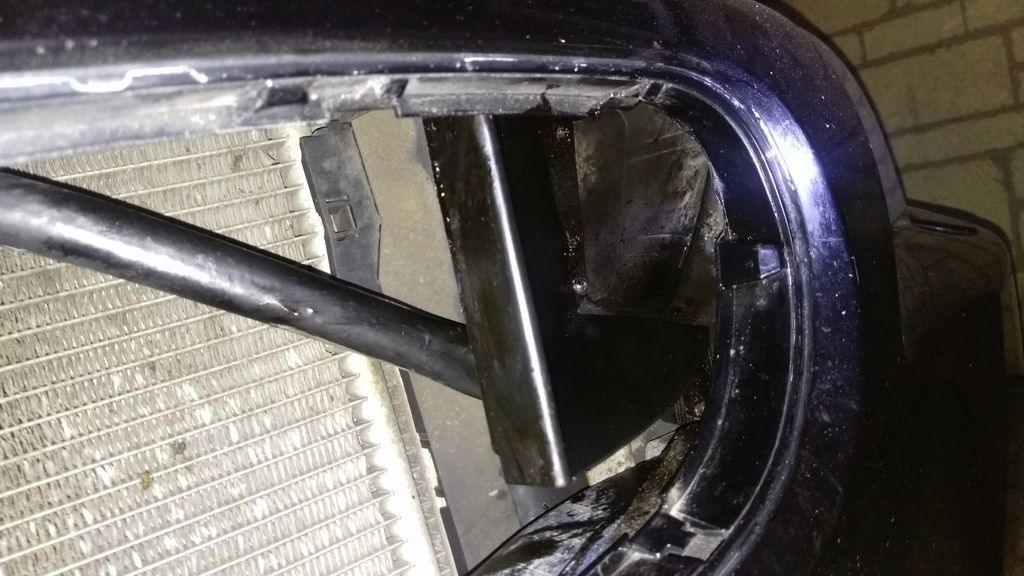

Good job - but I thought you had to remove the stock air scoop first?
pic no. 3:
http://raceprecision.com/forums/viewtopic.php?f=7&t=14
pic no. 3:
You do. I didn't think to mention that. Will edit it!

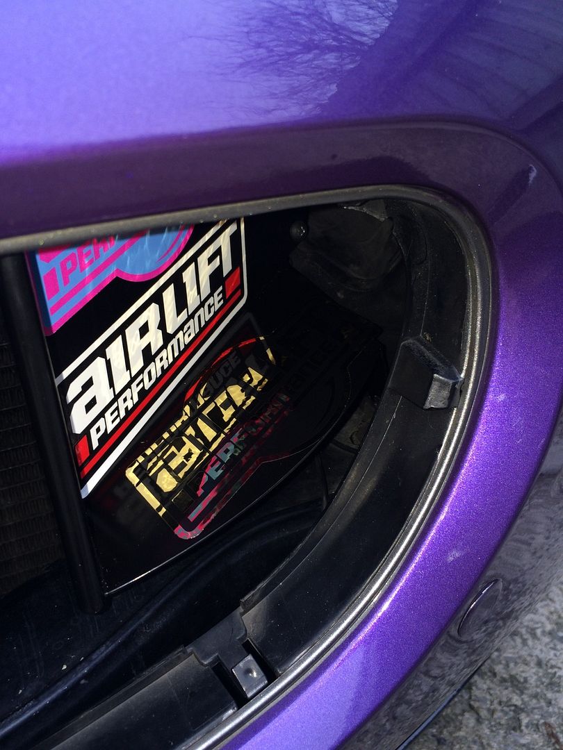

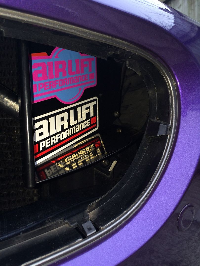

Got mine fit today, I made a vinyl rpi sticker but changed my mind. Was tempted to do an "RIP rpi" sticker but instead I stuck a few airlift stickers on just to make it subtly stand out when someone looks closely, I may change my mind again
I also found if you bend the top corner (like in the pic below) it makes the top screw dead easy to fit with no need to drill at and angle
Thanks for the tip regarding bending the corner. Think you made the right decision not to go with the home made sticker :poke: :wink:
I reckon the airlift stickers look good - may not suit everyones car, but yours can probably take it :thumbsup: Where did you get them from?
To be honest it I had done the letters properly instead of doing a rough cut out job it could have looked good. I should have measured the letters but I couldn't be arsed.
The stickers came with my airlift management and I had no use for them so stuck them on the scoop
