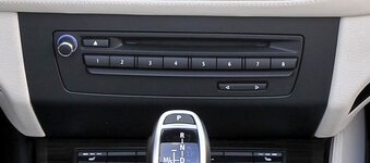

I will. This is what I already have planned. Remarks are welcome!
Within 2 weeks I will take delivery of a deep blue see 30i. I ordered no extra HiFi or USB options. These are way too expensive because of the Dutch luxury tax ( :thumbsdown: 40% :thumbsdown: ) on new bought cars. The Hifi speaker option (245watts) and radio professional with USB playback costs almost 1700 euro.
So I have planned to integrate a normal DIN radio unit. I have already ordered a radio frame that fits in the 1 (E81) and 3 (e90) series. I assumed this frame will also fit in an E89. I based my assumption on the fact that the BMW part list shows that the basic radio unit of the E89 is also used in the 1 and 3 series.
If this operation succeeds, I can order a Pioneer DEH-P5100UB radio unit.
This unit has all features available that would like to have (USB,sub amp out, low/hi-pass filtering on front/rear/sub outputs). I have order the black interior, so I guess this unit buildin within the DIN frame will look not that bad.
My next and the most important step is to add a fat subwoofer system in the trunk and better rear speakers. I want to design a custom made active subwoofer unit that fits under the opened roof. A bass reflex port/pipe should be integrated between the seats to get a better bass performance in the cabin.
Next I would like to replace the basic rear speakers by building in 2 Pioneer TS-S101PRS speakers.
I’m not sure if these speakers fit into the style of the interior. I will try to integrate them behind the existing speaker panels. If this speaker system is operational, I will decide what to do with the 4 front speakers.
Remarks/suggestions are welcome…

Congratulations on getting a new one, not many around here are :thumbsup:
I can't decide whether it will fit or not :idunno:
We will see within the next 2 weeks.
The standard radio (teilenummer 65 12 9 200 101) is at the moment used in:
1' E81 1' E87 1' E87 LCI 1' E82 1' E88,
3' E90 3' E90 LCI 3' E91 3' E91 LCI 3' E92 3' E93 and
Z4 E89 models.

My E85 has also the standard audio speakers. I guess the E89 system will not sound that differently. It will definitely have a lack of bass and high frequency will not sound very clean. Better speakers and an active subwoofer will improve the sound quality. But improving the quality of the navigation system basic 4x25watt amplifiers will be difficult. You won't have an audio line out signal to connect better amplifiers. To be honest Arnold, why not order the HIFI active speaker system (245watt). the number of options you have to improve the sound quality are limited, because of the navigation system.
