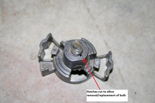

Finally got around to doing this mod to the Angel Eye’s since I have had 2 of them go bad within the past several years. I am putting this together for several reasons:
1) The bulb itself is made by Philips for BMW and is not available on the open market.
2) The Angel Eye is only sold as a whole assembly, not just replacing the bulb.
3) Cost of the assembly compared to just the bulb itself (plus I went with a higher wattage bulb, making it brighter in the process).
The AE assembly is located in the upper inside of the headlight assembly and is held in with 2 torx screws. Be careful not to drop these screws into the housing, as anyone with large hands will have a difficult time getting to them once they are loose in the housing.
If you have a dremel tool with a small bit, small drill bit, or a fine file, you can notch the edge of the AE assembly so that you only have to buy a replacement bulb. Cost for the assembly is around $45USD compared to $5 for just the lamp itself. Once you have the assembly out of the car, you will be able to see where to notch the assembly to allow quick and easy change of just the bulb.
The original bulb is a 12v, 10W made by Philips which is not available on the open market. There are some 12v, 10W bulbs available if you wish to stay with the original specs. I opted to go with a 20W bulb (Osram BC2615) for a brighter AE. The extra heat generated by this bulb is neglible and has not caused any problems. Be aware that for some reason this bulb is available, but is usually back-ordered through the distributors, and may take a while to actually arrive through the post.

Finally got around to giving the Zed some much needed love, including this mod, thought I would add a few tips even though everyone that intends to do this probably has already done so. Though if you bulb burns out and you just want to replace the stock 10w without spending a fortune, this still will help.
First, do not remove the retaining screws (use T20 Torx driver), just loosen them a full turn to turn and a half or so. Rotate the assembly anti-clockwise about 25 degrees to remove. Small hands help to get adequate torque, even with the screws loose, it's a fairly stiff snap release to initiate the rotation.
There's no trick release for the electric plug, though it can be fairly snug. Just keep pulling and wiggling, it'll come out eventually.
The socket inside the plastic assembly is a standard 2 pin metal socket with L shaped release paths cut into the sides. You need to drill the clearance slots exactly where the release path ends. This can be identified by turning the bulb anti-clockwise (while pushing slightly) and then pulling it as if to remove it. When the guide pins hit the plastic that prevents removal, you can just make out where the pins are through the thin gap. This is where to drill. If you hit metal you missed, the bit should fall through into the release path if you drilled in the right spot. If you miss, no harm done, the job will look sloppy but the bulb will still be properly retained.

Agreed. I just completed this mod and I have to say with wheel off the task is much simpler. The location of the AE assembly is far more recessed than the photos would suggest. You really need to get in there to be able to see where the screws are located. Once out, the job is a breeze. Drilled the holes exactly as in the photos and the bulbs came out without any struggle.
