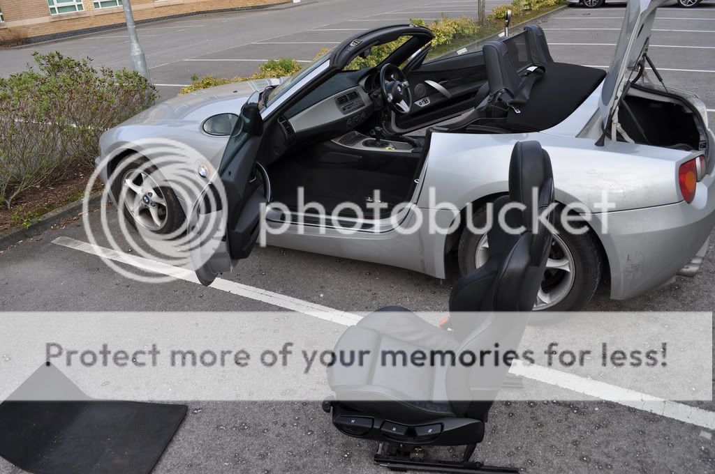

Next job was to take the driver seat out of the car. This was a very simple process, just unscrew 4 bolts and detach the seat belt from the seat itself. Then just unplug the cable running from the seat under the floor into the car.
Having got this out (wish I’d put the windows down to help easing them out) I was able to hoover 6 years worth of mess from the cabin. It actually wasn’t that bad, I was surprised it was so clean.
As there are no occupancy sensors on the driver seat, it was a simply plug and play. I reconnected the cable and at this point also reconnected the battery to test the seat movement. Very little point putting seats into the car that I wouldn’t be able to move.
Happily, the seat immediately sprang into life moving when I pressed all the buttons. 10 minutes later, I had reattached the seat belt, hooked the seat over the bolts at the front, located the bolts at the back and tightened everything up.

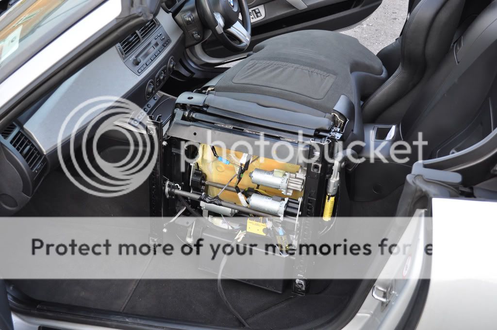

With both seats on their sides, I unplugged the sensor cable on the new seat and taped it to the frame away from the other wiring as I no longer needed this.
I unplugged the same cable from my old seat and traced it around to a black box. Out of this box came a blue wire and a white wire. I cut this and removed the box from the seat. I then connected my bypass unit (thanks to Dellboy for pointing me in the right direction) to these wires.
I then plugged this back into the connector under the new seat.
Then I had to venture out into the cold (it was about 0 degrees now) and test it in the car. I laid it in the cabin, reconnected the battery and turned the ignition on, hoping I wouldn’t see an airbag light. No light stayed on, and the seat moved on its base.
