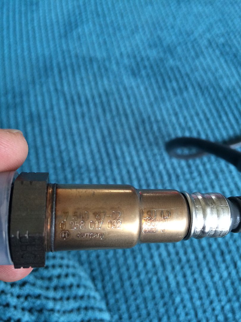

This is the BMW one for our cars: (BMW Part number 11787540167) (Bosch part number: 0258017092)

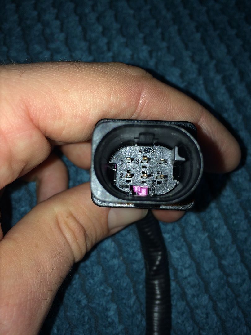

As you can see 6 pins and a pink switch - Open / Closed

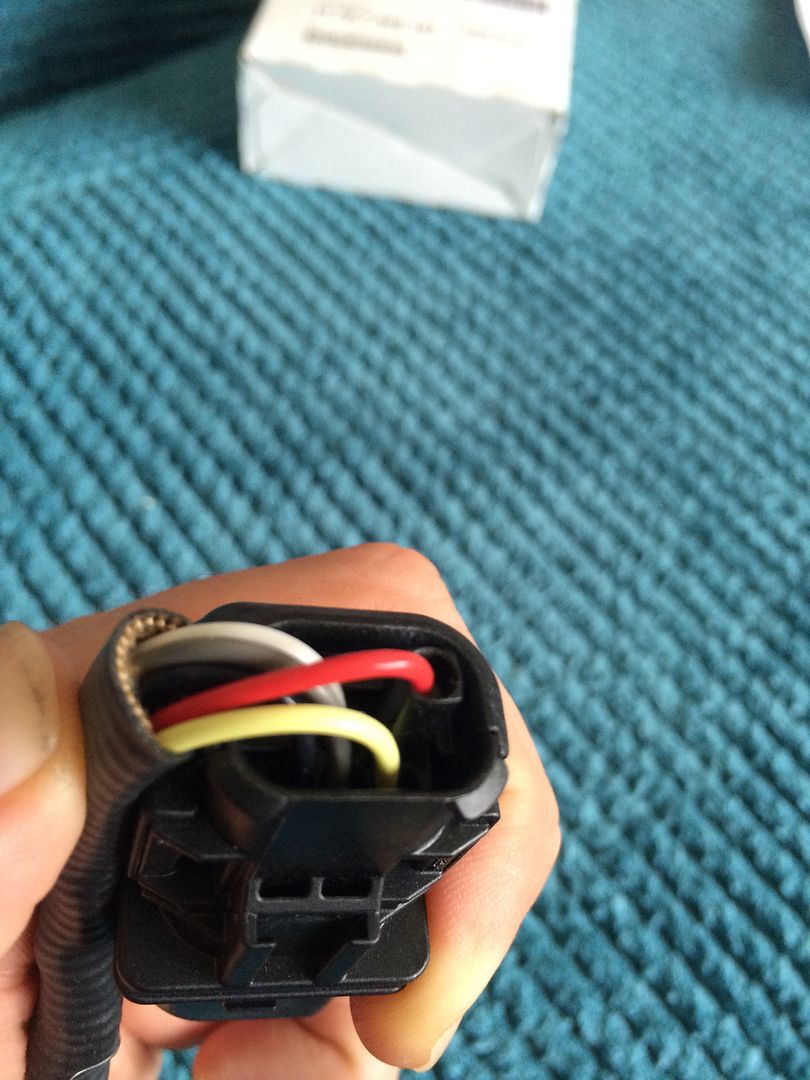

Definitely only 5 wires here(white,grey,yellow,red,black)......so why 6 pins? Spoke to a Lambda reseller this morning, he says it's a Bosch thing, one pin is to test and calibrate it, it's not used when it's on the car.....so says. Does kind of make sense.
The BMW and Bosch part numbers stamped

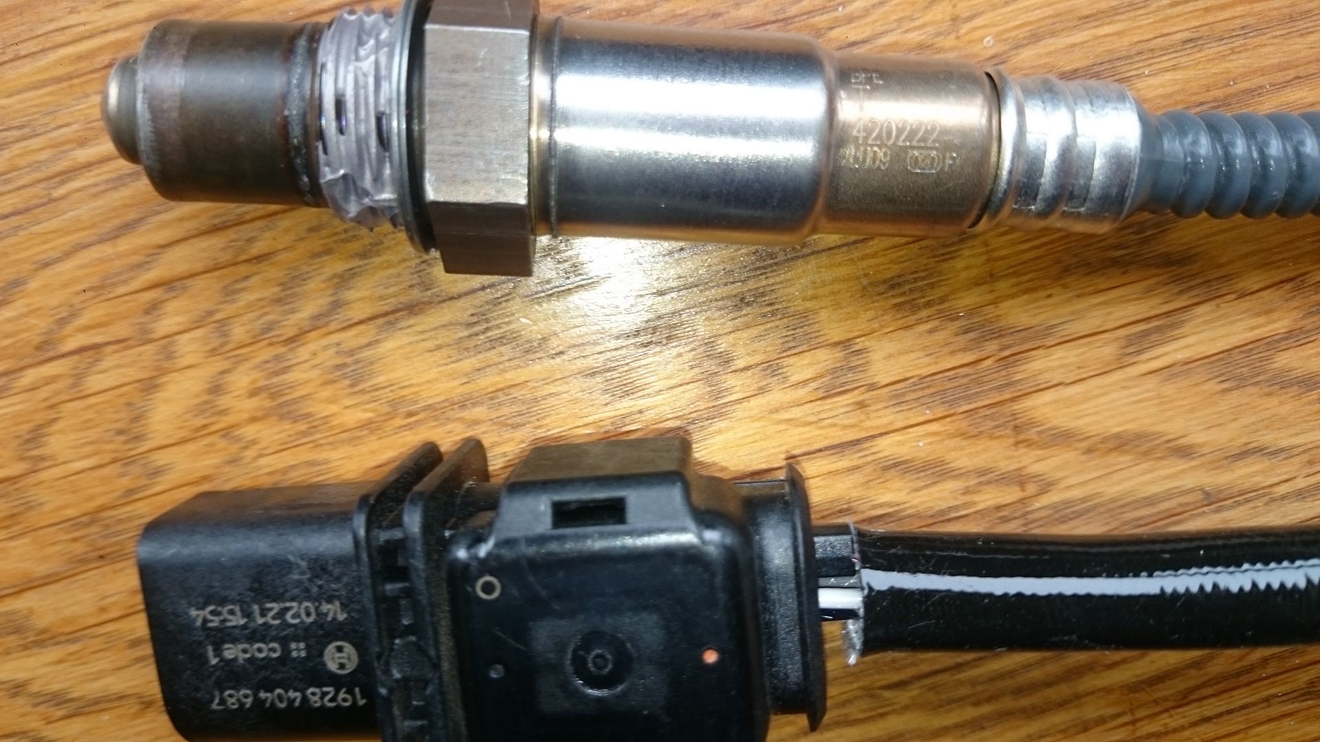

The E46 M3 one is a slightly different design, has 4 wires / 4 pins and is a shorter length / differing lengths, looks a different design as well for whatever reason. Being the same engine I can only imagine it's a DME driven difference that it takes a new design of Lambda but yeah a lot cheaper, around £70!
Anyway, getting it in stock is definitely an issue at the moment. A lot of German/Euro Bosch sellers are saying the same as companies here, it's not in stock and don't know when it will be

I always thought the z4m came with the lsu 4.2 widebands, but your's is saying 4,9
(4.2 takes reference from outside air, 4,9 takes reference from internal air chamber afaik)
Anyway that connector is pretty standard for lsu 4.2 and 4.9 sensors. You can get generic ones as low as £60 or so.
The 4 pin O2 sensors are narrowband.

Ah cool, good info, yes getting a bit of an education looking into these! Mostly the same part's with different wire lengths is the biggest difference more than the sensor itself.GuidoK wrote:I always thought the z4m came with the lsu 4.2 widebands, but your's is saying 4,9
It's definitely LSU 4.9, I've been told by a few companies now that the specific Bosch part for the Z4M is out of stock but other Bosch sensors which are the same but have a slightly longer wire are available. Notably part no: 0258017025 is in essence the same albeit a slighty longer wire......decisions decisions! I'll probably keep scouring for the Z4M one and if I can't find one just go for one of the other sensors with a slightly longer cable.
The more I see of basically the same Lambda but with different wire lengths sub £100, the more I find BMW's asking price a total piss take!
