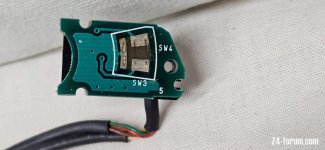

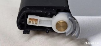

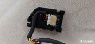

Received the paddles today. These are the chips inside:
The big brass pin slides out easily, so if you did want to keep the black bit as is and just swap out the paddle then this would be possible. However it would be easier for you to just swap the chips like you wanted to do if they fit.
[ref]Usel[/ref], it won’t surprise you to hear that I snaffled the £20 steering wheel. The left hand chip is indeed the same as the Z4 auto, as it corresponds to the picture posted by [ref]1236Z4[/ref]. I have no reference for the right hand paddle, but the serial number is consecutive so I am hoping it is also identical to the Z4 auto (the left and right are not the same). The wiring loom is very different to the SMG. I have connected F to A, cut the white wire and attached it to the steering wheel earth. I have replaced connector E with the right sized slip connector from my SMG paddles and discarded the rest of the loom B-C. Hopefully you agree. Unfortunately I can’t test it yet as my front end is on axle stands ☹️, but I’m hopeful.

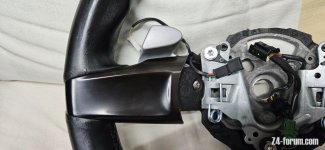

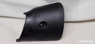

Are the rear trim pieces on the back of a paddle shift steering wheel the same as a normal steering wheel?
I have drilled the holes and bolted on the paddle on the left hand side, it all fits like it's oem tbh:
However there is not enough room for the trim behind.
Do yours look like this:
