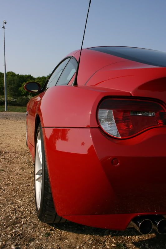

The car is kept pretty clean and tidy, and regularly waxed, but was in need of de swirling after some dealer inflicted swirls and general wear and tear.

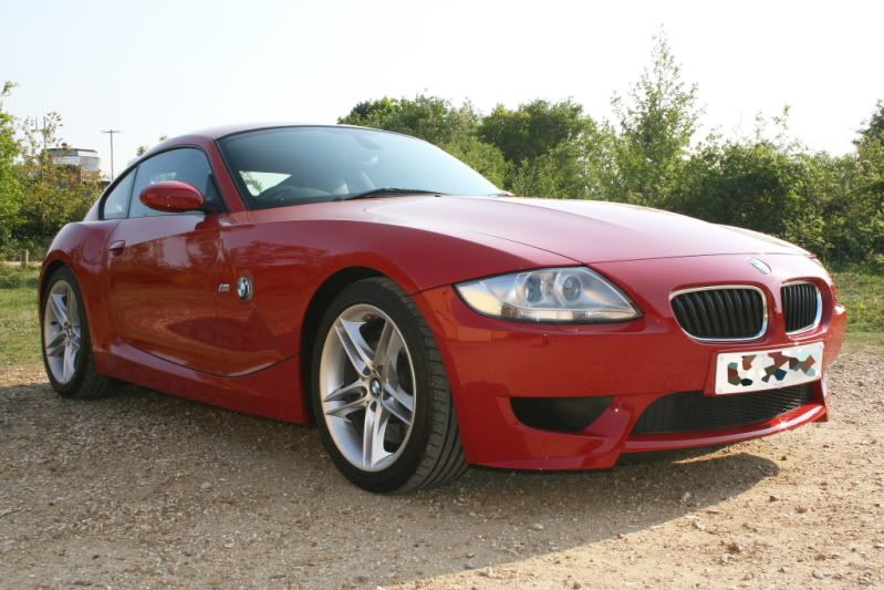

This was how the car looked at the beginning, not bad for a 400 miler a week, but far from perfect:

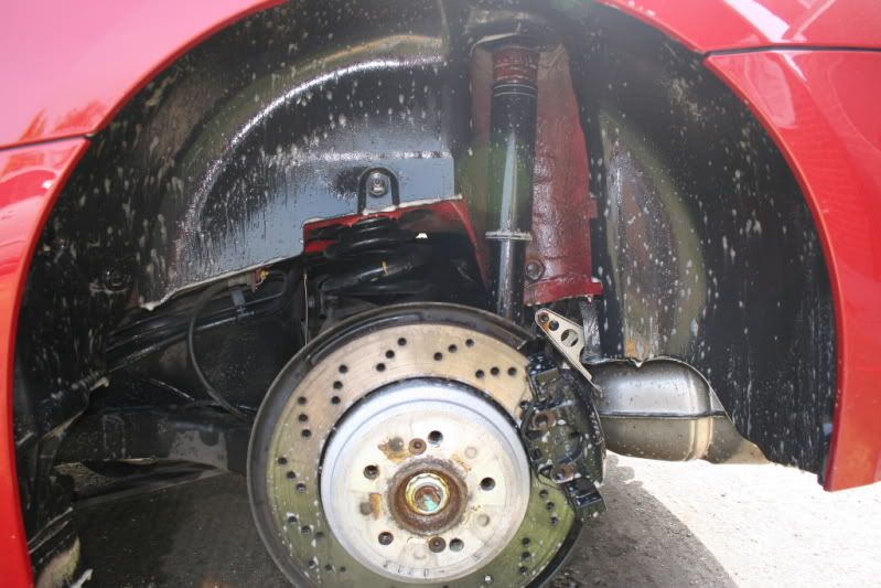

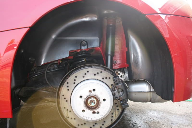

First up was removal of the wheels to allow cleaning of the arches properly. First sprayed with Megs Super Degreaser cut 4:1, then after being left to soak sprayed with Megs APC cut 6:1:
This was then agitated:
Then rinsed and finally all plastic was dressed with Megs Hyper Dressing (10:1)
Wheels were then cleaned inside and out and sealed with Poorboys Wheel Sealant. No pics of the wheels as they were already well cleaned, and you all know the normal process

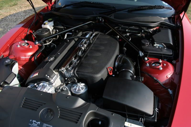

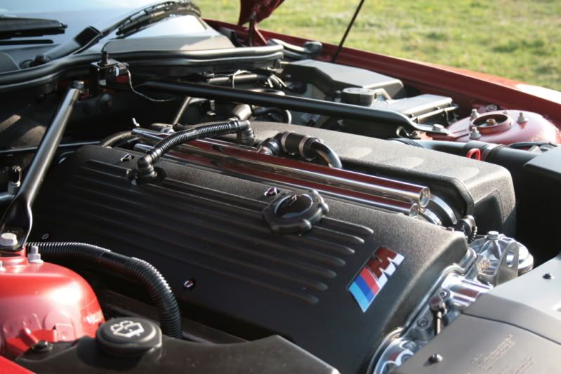

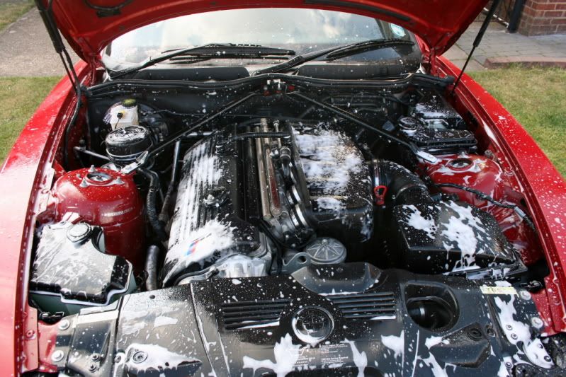

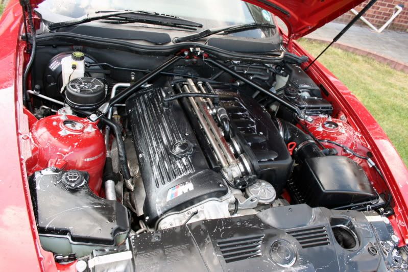

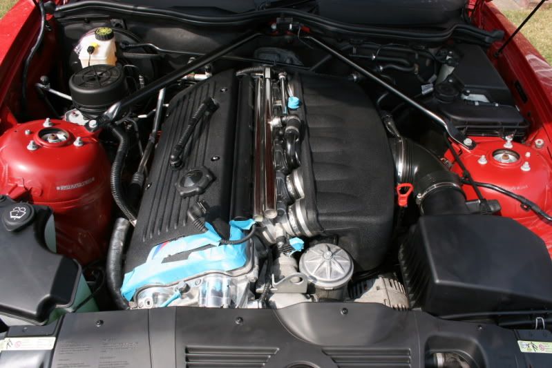

Next job was the engine bay. Engine bay was sprayed with Megs APC:
And agitated to remove stubborn areas of dirt, although I regularly keep on top of it so nothing major was needed.
Engine was then rinsed with water from a hand pressure sprayer and wiped down with MF's. Paintwork was polished with Poorboys Blackhole and then seamed with Poorboys EX-P.
Parts of the engine were then taped up for some more attention to the metal work, where they were polished with Autosol metal polish.

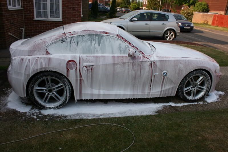

Whole car was then foamed with Megs APC:
Then washed with the 2 bucket method and a sheepskin mitt. Car was then clayed all over with Sonus green clay and Megs last touch as a lube.

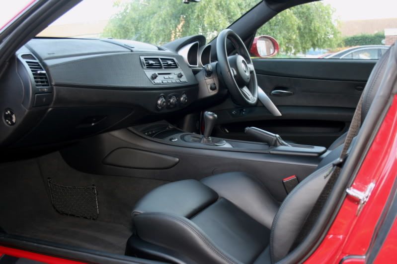

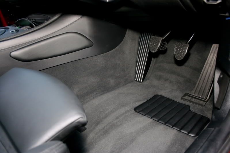

Finally the interior was fully vacuumed and carpets wet vac'd. All surfaces were cleaned with APC (10:1) and left to dry naturally. Meanwhile seats were cleaned with Gliptone Leather Cleaner and the conditioned and left to dry. Finally the dash and plastics were dressed with Poorboys natural look dressing.
So some afters:
Interior:

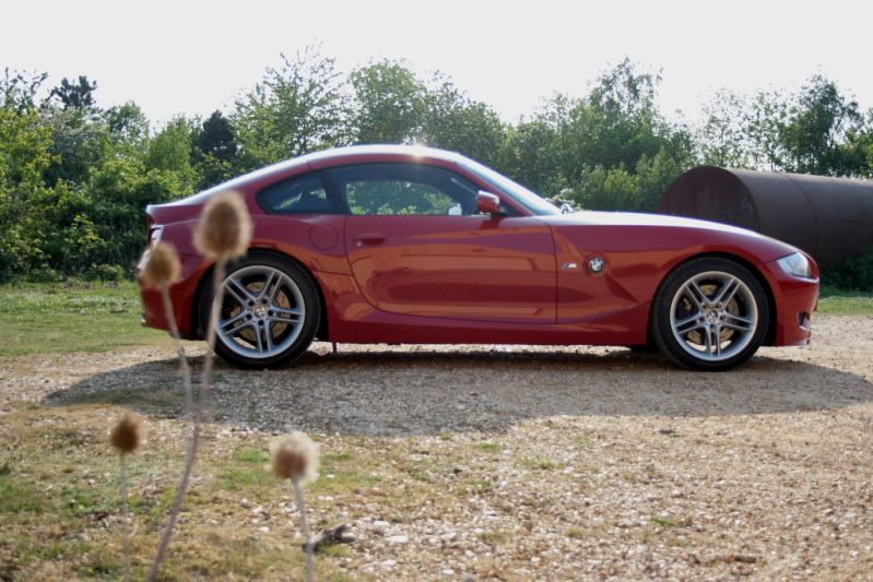

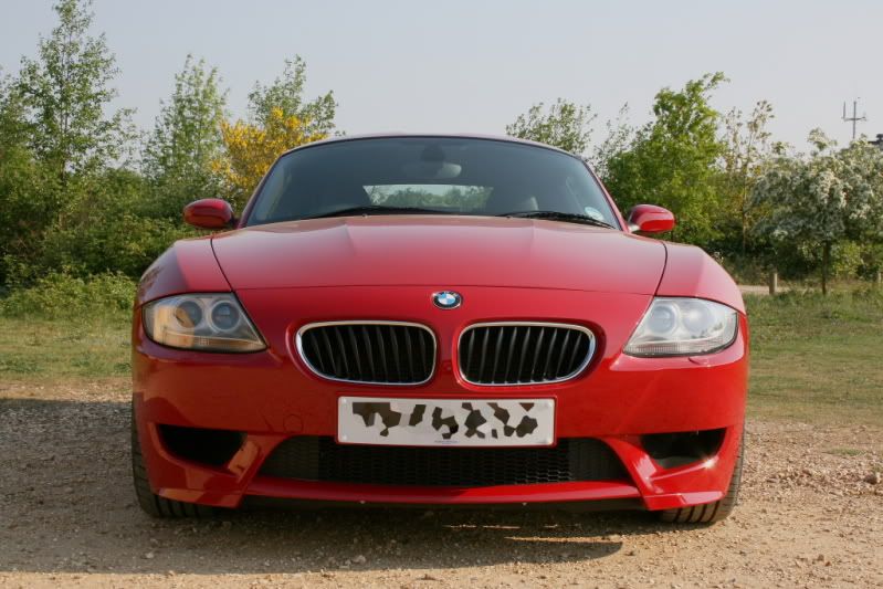

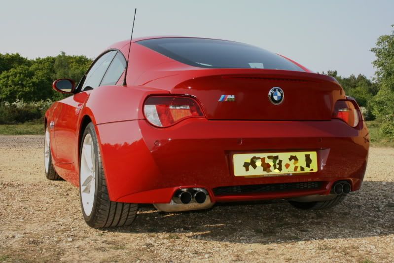

Exterior:
Engine Bay:

Interior:
Exterior:
Engine Bay:

When hosing off the engine did you tape anything up to stop water issues?

For the engine bay I didn't actually hose off, I used a hand pressure spray, something like this: http://www.screwfix.com/p/hozelock-pres ... yer%207LtrHark wrote:Looks good mate, interior and engine bay looks superb.
A couple of questions.
What did you use on the tail pipes? Autosol has made a difference on mine, but some stuff won't budge.
It makes like easier to control and doesn't throw loads of water into the bay. I did also covery up the alternator with some cling film just in case along with anything else that looked exposed and expensive.
As for tail pipes, I had previously done them before so this was a tidy up. But the steps I used when I first got it, and have used on other stainless pipes, this assumes dirty engrained and tarnished metal work:
First Wash with a strong soap like APC to get rid of the crud.
Then wheel cleaner to get rid of more ingrained stuff. Soak it properly, and then soak some fine grade wire wool with the wheel cleaner, and scrub - this will introduce marring but will be clean. This step I haven't seen others advocate too much, but it works for me, you may want to stick with APC - the thing is never let it dry. Then rinse, and rinse more, and again.
Now do the same with APC, just to make sure you removed the wheel cleaner.
The pipes should be clean now, and ready for polishing.
Get a pot wth very soapy water, and get some wet and dry paper (starting at 800, 1000, 1200, 1500, and maybe 2000) - soak the paper in the soapy water.
Get a hand sprayer with a soapy solution in.
Now spray the metal pipe with the soapy spray and get the roughest paper and start polishing, keep spraying to keep wet until the paper looses it's cut. Repeat for all paper grades, you should now have a perfectly smooth finish but probably dull. Now get some very fine grade wire wool and autosol, and get polishing - it will quickly turn black. Buff up with a microfibre, you should have a shiny finish now. Repeat for more shine.
If you want a really shiny finish you could go to a dremel with a felt pad and plenty of polish either after the wirewool stage or instead of.
Also Megs NXT metal polish I think gives a slightly brighter shine IMO
