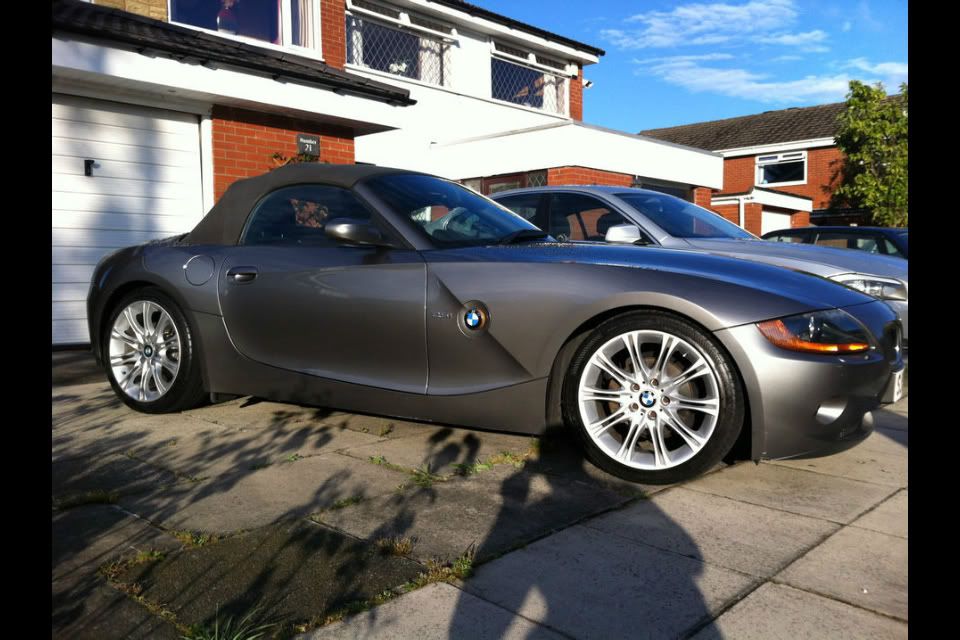

Ok here is a picture I've got from the advert.
Thanks for the help with photo bucket!
Doesn't look too low to be honest - is your driveway sloped ?
