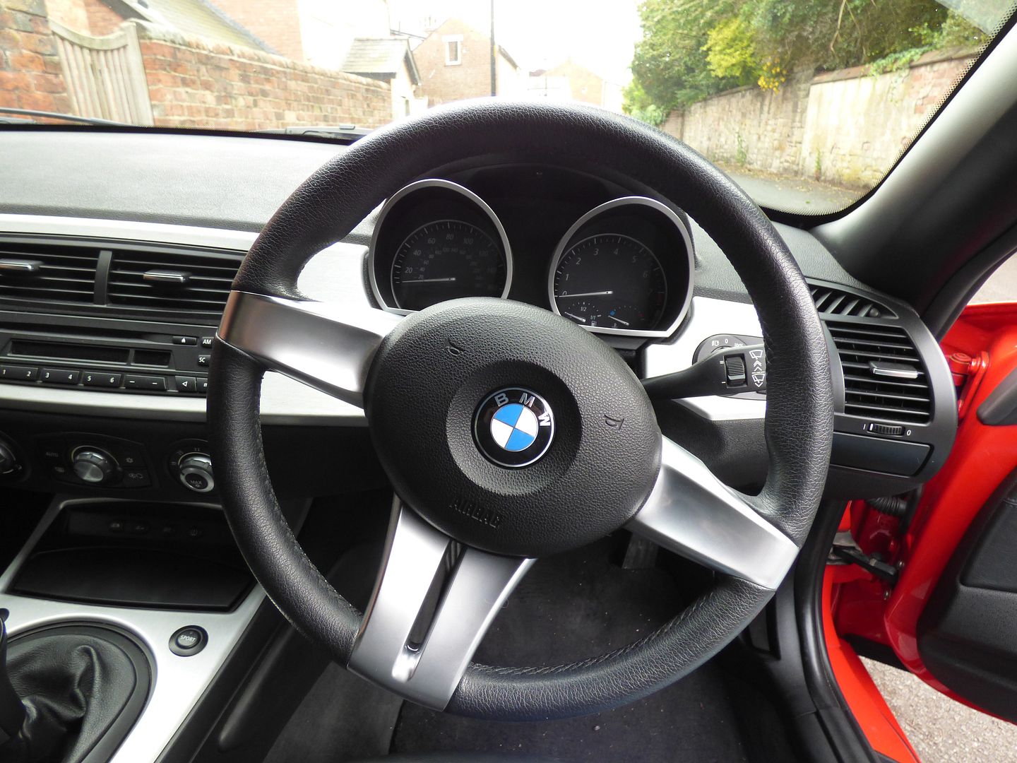

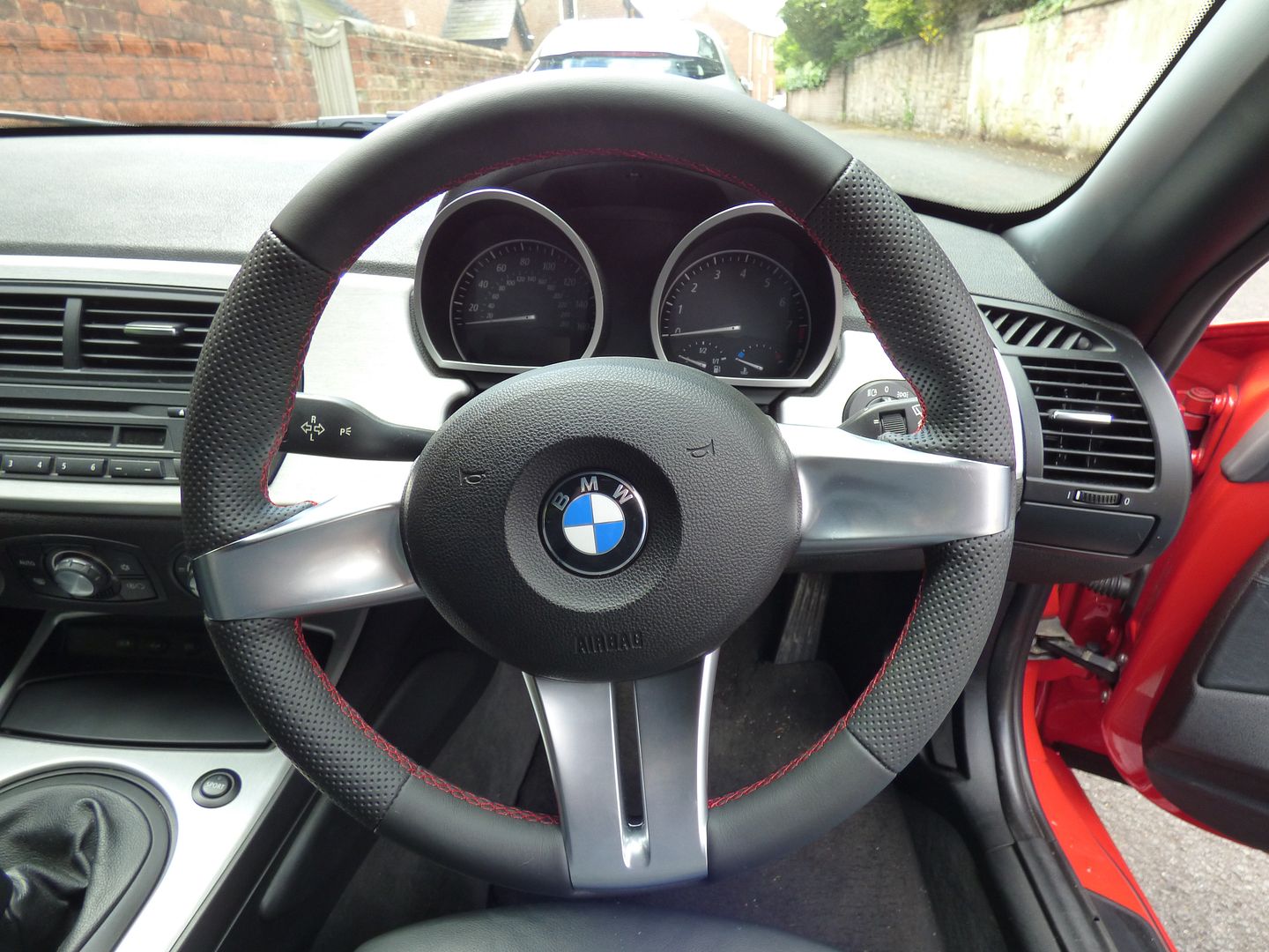

Before and after pics of my royalsteeringwheels replacement steering wheel:
Before:
After:
Feels much better :driving:

Well Royal Steering Wheels have various options, if you live close they will swap the wheel for you. I don't, so I went for the mail option: Basically you pay up front plus a £50 deposit and they send you a re-trimmed wheel. You then swap it out yourself and post back your original wheel and they then return the deposit. There are links on here that show you how to swap out a wheel (do a search) but that assumes you are receiving a brand new wheel with inner plate and all the connectors. Royal Steering Wheels send you a completely stripped down wheel so you need to swap out the inner plate and the spoke trims too. I needed to buy a set of star keys to complete the job.

Double padding - I would definitely recommend double (It's still not as chunky as the M Sport Wheel even with double padding)
