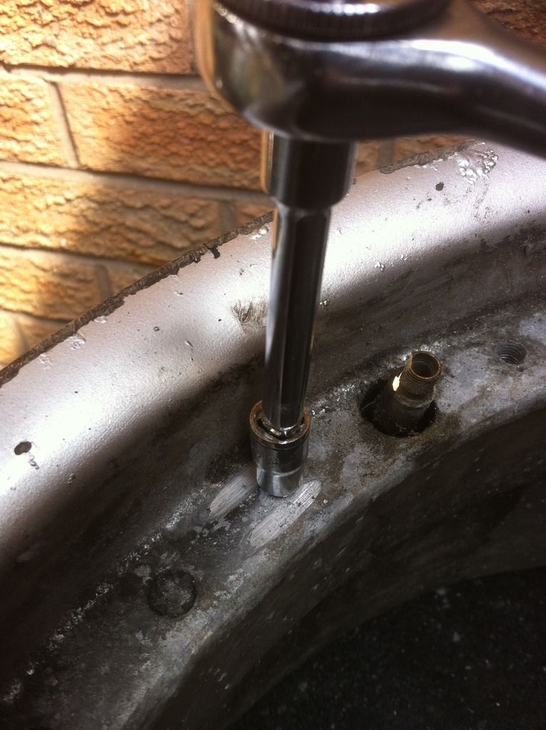

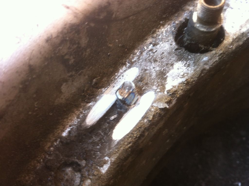

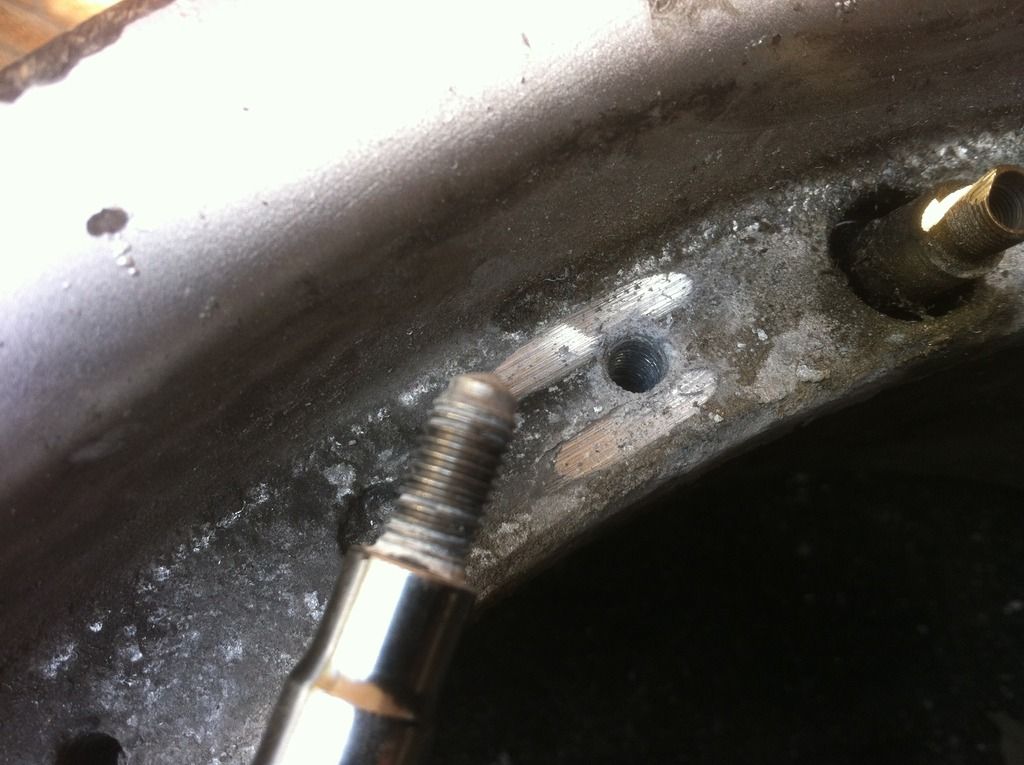

Not had a set for a while so no pics taken previously but i have been asked htf do you get them out once snapped
I know there are members who have 108s either part split or with bolts to remove so hope this helps . its not exactly high tech but it is pi55 easy .
I bought a set last week & out of the 80 bolts i had 2 snappers well here's how to remove them in under a minute
You need a small grinder , selection of small sockets & a hammer
Step 1 is to grind 2 flat sides on the protruding bolt
Step 2 is drive onto the bolt a smaller socket
Step 3 extract the bolt
Removal of snapped 108 rimbolts the mr wilks way

Instead of hammering a socket onto the bolt after you have 2 flats on it you could grip the flats with mole grips and then put a bar between the teeth and turn them out that way.
Seen this done with disk bolts on bike wheels but same thing.
