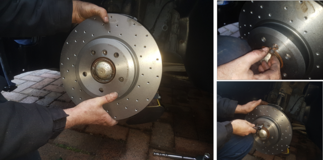

I started on the rear discs. So first thing's first, jack up the car and remove the wheel.
Undo the two 16mm bolts on the rear of the caliper. Then twist and release the caliper.
The brake discs are held on by a single screw that requires a 6mm allen key to release. Then the disc can come off.
It's at this point I discovered that the 294mm Brembo brake discs I had purchased were too shallow to allow use of the handbrake, nor would any 294mm disc fit. So frustratingly, after all that I had to abandon ship, rebuild and move on to the fronts
However, the steps above apply equally to remove the caliper and disc from the front wheel and I had better photo examples of them as right about now the heavens opened just to rub salt in the wound. But that wasn't going to deter us, so we ploughed on.
Again, repeat the steps above for the front procedure.
- Jack up, wheel off
- undo 16mm bolts, caliper off
- undo screw with 6mm allen key, brake disc off
Undo the brake flexi pipe on the rear of the caliper with a 14mm spanner and remove the pad wear sensor. Then twist the caliper off completely.
Now you can mount your new 325mm brake disc and re-insert the screw we removed earlier.
Undo the pistons from the caliper carrier and mount the carrier to the brake disc.
Screw the flexi pipe onto the new caliper, you may need a caliper compressor at this point. Insert the brake pads and bolt the caliper on, reinserting the pistons. Attach the pad wear sensor.
Wheel back on and we're all done. Besides the palava with the rear discs it was actually a lot easier than I expected, and looks a damn site better than beforehand! Hope this helps anyone thinking of doing the same.

If anyone is literally following those instructions then don't forget the all important brake fluid bleed at the end. The reservoir probably needs topping up afterwards too with the fluid that now goes into the new caliper.

Of course that should be in there, bleed the brake fluid, pumping and releasing the brake pedal.

1) Yep they bolt straight on, it's a fairly simple swap really.groovy_hippy wrote: ↑Sun Oct 08, 2017 8:28 amReally good thread, except you're giving me ideas ha!
Couple of questions:
1) Assuming from your post that the front calipers, carriers and 325mm discs from a 330i will bolt straight on?
2) On the rear, you're fitting Z4 294mm discs, but which calipers and carriers?
2) The calipers I have for the rears are off an E46 328i which also bolt straight on.
Yes both discs and pads are Brembo. I also have Brembo pads for the rear, but I haven't been able to find any Brembo discs suitable for the rear. Sticking with the drilled disc theme I managed to find these http://www.mtecbrakes.com/brake-discs/b ... 06-06.html but there are very limited options about with a deep enough hub.

One thing I would add, is that it's VITAL to make sure the hub surface is properly cleaned before firing the discs. Best way is an angle grinder with a wire brush cup. Any rust or deposits can cause disc run out once they are used.
Don't know if you did this step?
Mike

Yep done today, forgot this yesterday but I only did one side yesterday due to the rain, so I've done the other side today and refitted this one too. Thanks for the tip!

Just reading this thread and this answer bothered me a little.
Are you using the bleed nipple on the caliper to bleed the brakes?
Its just the answer you have given kinda makes it look like you have just pumped the pedal.
