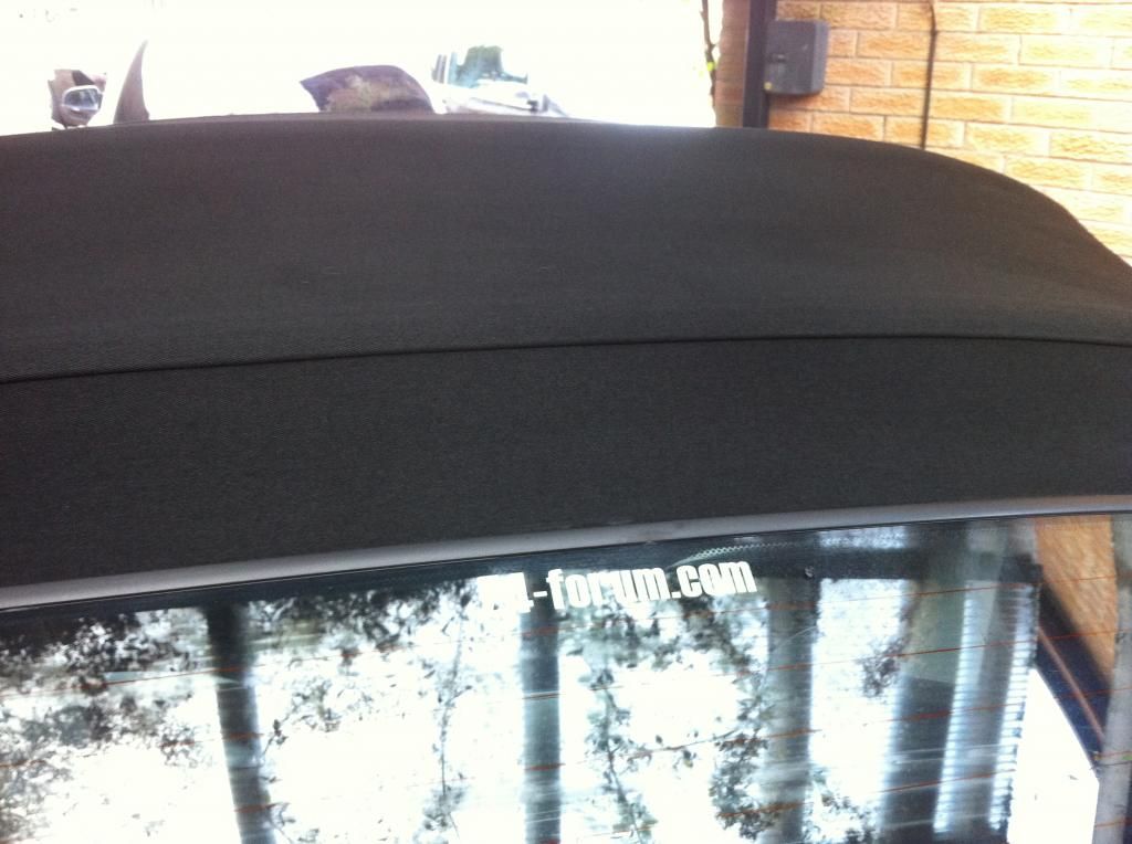

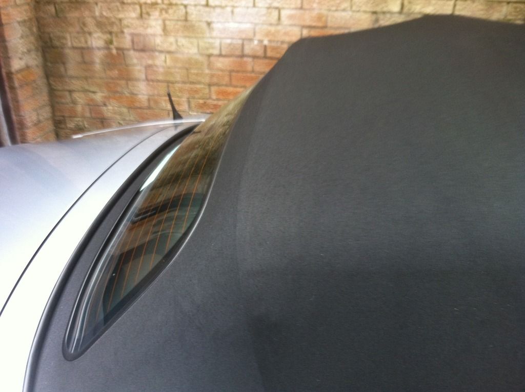

Not looking too good there is it
Ive had them worse than that & it really doesn't take much to make them come back to new
A few hours effort & maximum spend (£20 )
Jmo but I would hold back from applying any form of waterproofer until you have it looking A1
This is how it should be after a clean & dye , then think about sealing

That looks brilliant, Andy. What products out of interest? I'm a clean freak but no experience of dye-ing (dying looks/sounds wrong )mr wilks wrote:Not looking too good there is it
Complete hood make over help
Can you recall what you used here, Andy?mr wilks wrote: ↑Thu Feb 23, 2017 8:41 pm Not looking too good there is it
