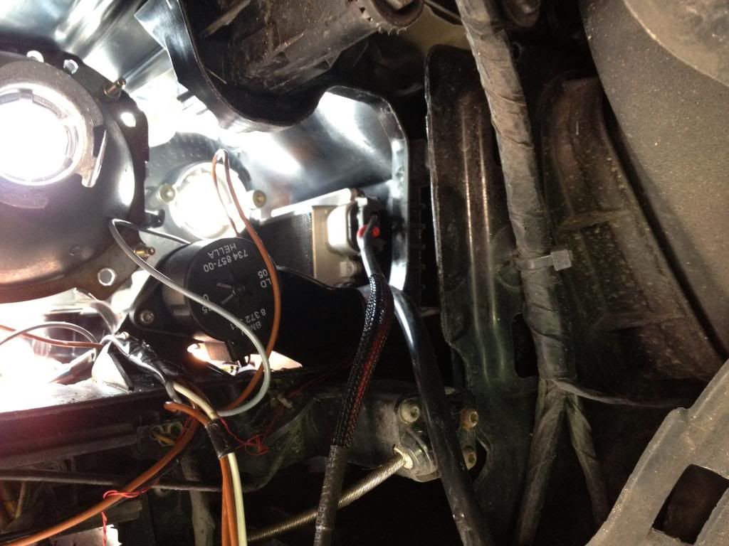

Tip 1 - Disconnect the battery. When working on the vehicles electrics, it's always a good idea. I would also suggest that before you fit the new bulb and ballast into place, you connect them up to the vehicles wiring harness and check they work. I was unfortunate enough to have one faulty bulb upon checking. However once I contacted the supplier they sent me out a new pair free of charge straight away.
Tip 2 - Where to mount the ballast. Looking at the photo below, I've highlighted the area where the ballast can be mounted. The photo shows the rear of the nearside headlight with the cover removed. Highlighted with a red circle is where I mounted the ballast. I'll warn you now, it's not easy getting it into that gap, even harder once you've got sticky tape on the back of the ballast! I mounted my ballast using two number plate sticky pads.
Tip 3 - Remove the rubber grommet as it won't be needed, this also frees up the wires making it easier to mount. Doing this also allows you to pass the H7 clip over the wires.
Tip 4 - The kit should come with 2 new projector H7 mounting clips as shown below. I decided not to use these as they don't fit very well with the Z4's headlights. Instead the original clips can be used. Pass the wires and connectors from the new H7 Xenon bulb through the connector. It's a very tight fit, but with a bit of persuasion they will fit!

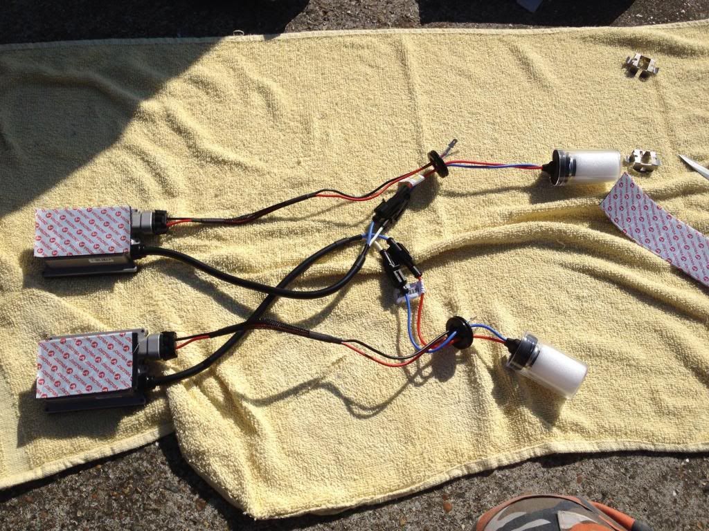

I removed both rear covers and let the air circulate into the headlight assembly. I also took the seals right out and let them de-stress and sunbathe on a clean dry surface. (We all know what it feels like to sit in a cinema for 3 hours with numb bum syndrome.)
The seals do a fantastic job and letting them relax does rejuvenate them quite a bit.
The wiring loom all made up before placing into the headlight with adhesvive velcro on the ballasts. I also cut off the grommet as its not needed. I left the bulbs in the protective holders and took great care not to jolt them about on install.
The location for the ballast (drivers side). It fits perfectly. I put the furry velcro on both sides of the ballast box as I did not want rubbing on the parts when it is in position. The longer side of the ballast needs to sit on the wall. More surface area to stick eh!
Here is the ballast fitted (passenger side). I put a piece of electrical tape on the film that protects the adhesive so the ballast can be slid in, then the tape pulled to activate the glue. It saves it all getting snarled up as there is not much room to maneuvre. Especially with the wheel in the way!

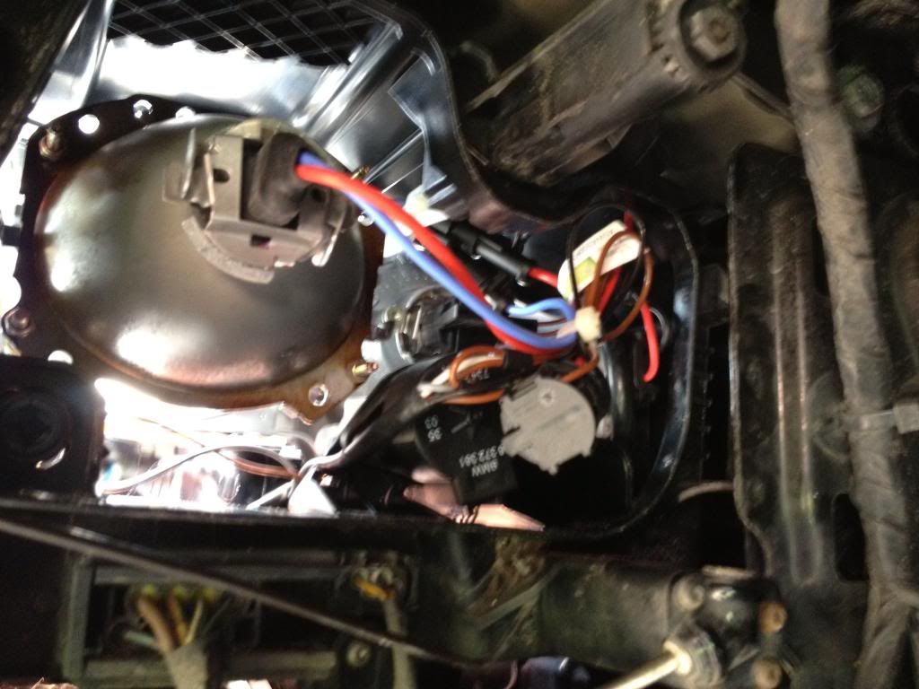

The retaining clips are a pain, flimsy and ill fitting. I spent more time (and adding funds to the swear box) with needle nose pliers manipulating the ears to get a nice fit. The ears need to be pulled out and flattened to get a tight fit otherwise it keeps popping out.
It really is well worth the time practise fitting the clip to get it right. You wouldn't want the bulb coming out and have to mince around at the roadside to fix it all back (if it hadn't shorted on the housing). Once you are happy, you can fit the bulbs in!
The original bulb holder with the metal clip removed. After testing it worked I wasn't happy that the plugs just pushed in and there was a little of the plug still exposed that had a possibility it could touch something causing a fault or short, so I used self amalgamating tape the seal the wires nicely.
Here is the finished article (apologies for the slightly blurry shot). I am really particular about dressing cables (Hifi crank!) and I think it is importaint in the headlight too as it has moving parts so I cable tied them together and placed them away from the dipped beam so it has plenty of room for air and movement. I also made sure that the orginal bulb holder was close to hand in the event of a failure so you could temporary switch back to halogens in limp home mode.
Ready for re-installation. I thoroughly cleaned the seals, the cover and the housing lip as there was quite a bit of grit. It is well worth being OCD on this bit as the grit could compromise a tight seal on the light. I also vaselined the seal before putting it back in the housing so it gives a real watertight finish.
One last thing. The original halogen clips glued in with silicone sealant in each headlight. (For emergency use only!)
