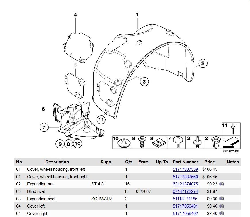

I just got my Z4M back from my very friendly "official" BMW garage where they did some body repairs on my Z4M (new front bumper, new front inner wheel arch on each side - splashguard, new front side body panels on each side). I noticed that there are now all bolts instead of plastic revets holding the inner wheel arch to the front bumper. Before the repairs it was only plastic revets on this place and no bolds on my car... My dealer told me that the bolds are the correct way of fitting and that it was previously wrong on my car. He also showed some pictures of recent BMW's from the showroom and indeed on these new cars it are all bolds on this place and no revets...but a Z4M is far from a new car of course. But maybe it is the new and better way of fitting these and that is maybe the reason why it says "up to 03/2007" with the expanding rivets on the info of realOEM.com.

Info from Real OEM (where it says "up to 03/2007")

On the info from realOEM it is stated; up to 03/2007 with the expanding rivets. Maybe it was the old way to do it and they changed this after 03/2007....when bolts became the "modern" way to do it....?

Never seen one anywhere with other than rivets. 2 designs of them fitted, some flush and others have a head on the locking pin
Other models do have bolts, so I expect he mixing up models and ages

My 03/2008 built still had the plastic rivets. They just changed it from the expanding rivets to blind rivets, but still plastic rivets

You'd have thought they'd at least find some black bolts... mine has the plastic blind rivets too, that you push the pin through to take them out. You can buy bags of them off eBay for small money if my memory serves me correctly.
