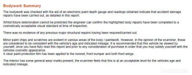

Hi Guys,
I am about to pull the trigger on a new purchase and had an RAC Check done on the car.
From what he says it looks like the car has been in a front-end bump most probably after March 2018 (he says this this as the front passenger headlight is not an original and was replaced and the date is 2018).
The passenger side front wing is not original and has been replaced and been fully re-sprayed. The panels down each side minus the back doors and the roof (to blend it in). He says that this has been done very well. There is no structural damage on the car.
I guess the question that I need to work out is does it matter? And will it effect the resale value of the car if I sell it in a couple of years? It’s clear that the car has been well looked after otherwise. FSH and loads of money spent on it.
What's everyone's thoughts?

Just had a chat with the guy and he was surprised as I was. He bought it from a garage too and they didn't mention it. The car has had a full MBSH and they haven't seen anything wrong with it either.
My head says buy it. It's not a problem but the RAC man scared me a bit with his chat.

Well that suggests the RAC only spotted it by checking the paint depth and does say there was no evidence of any major structural repairs.
I'd go and look at the car myself as they suggest and see if you can spot it. If you can't then it's unlikely anyone will when you come to sell it, so I wouldn't be too mean!
