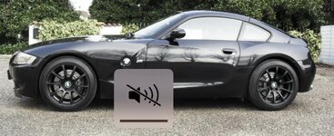

Currently running 255/35 225/40 on MV2s on my coupe and I'm looking to increase the sidewall to improve the ride a little bit (styling too imo).
I want a slightly bigger sidewall, similar to below;
(Credit to the owner if they're on here)
would 255/40 and 225/45 achieve this with the MV2's size?
What tyre sizes are you running on MV2s?

I doubt if going up one profile each end would cause a problem.
The standard tyre sizes on the Z4Ms was 225/45x18 on the front and 255/40x18 on the rear, although for much the same reason as you I had 255/45x18 fitted on the rear of mine and haven't had any issues!
It will alter your speedo, but given how all my BMWs have over-read it will probably just make it more accurate.
But if your car is still on run-flats probably the best thing you can do for ride quality is to get rid of them whatever sizes you decide to get!

Interesting - I'm not on run flats but the ride could definitely do with some improvement, will consider 255/45Mr Tidy wrote: ↑Mon Jun 28, 2021 10:34 pm I doubt if going up one profile each end would cause a problem.

255/35 to 255/45 is a huge difference. most common understanding when changing wheels and tyres is to be within 2% of the original wheel diameter, going from 35 to 45 is 7.4% difference.
doing that would also add a full inch of ride height, so the car would be less of a low slung sports coupe, and look more like an off roader
personally, the furthest i'd go would be 255/40. or even 245/40 would go perfectly fine on a rear MV2 wheel.
have you considered dropping a wheel size? if ride comfort and big sidewalls is your thing, sell the MV2s and get some 17" wheels instead. could pair them with a 225/50 R17 and a 245/45 R17

Dropping to 17's was my first idea, but I figured changing tyre size would be a cheaper experiment.brillomaster wrote: ↑Tue Jun 29, 2021 11:32 am have you considered dropping a wheel size? if ride comfort and big sidewalls is your thing, sell the MV2s and get some 17" wheels instead. could pair them with a 225/50 R17 and a 245/45 R17
If I could find someone that would swap some decent looking 17s in need of a refurb (with tyres) for my MV2s (in need of a refurb + with tyres) I probably would in a heartbeat.
