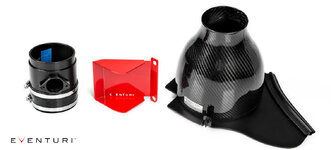

Yes, you are quite right. I think due to a combination of all my air-boxes having a MAF tube in the kit...and me not seeing my own car's engine bay for a few years (don't ask), I've obviously forgotten what it actually looked like
All the intake kits I've seen (not sure about the cone filter ones) do have a replacement tube/collar for the MAF sensor. You may even be able to buy the MAF tube by itself to add a correctly-sized cone filter on???
However, I'd still recommend getting something that has some sort of airbox housing.
AFE
eVenturi
Gruppe-M

I will eventually get the Eventuri I think, but with new baby just arrived, no way I can get 800 big ones past wife at moment.
