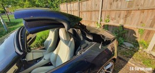

So as you can see from the photo, the boot appears to be out of movement /sync with the opening operation, therefore can't really use it at the moment
- 20230524_190240.jpg (181.5 KiB) Viewed 1061 times
- Screenshot_20230524_192415_Gallery.jpg (148.89 KiB) Viewed 1061 times

Did you find out what the problem was and did you manage to fix it? I have the exact same problem. The battery seems ok as I've just done 1000 mile trip and no problems starting.
The boot section doesn't open quickly enough before the rear screen section fouls it just as your blue circles on your photo indicate. I can assist the boot section manually or jiggle up then down a few times and it will eventually open right up to allow the window section to fold right down without fouling. There is plenty of hydraulic oil in the reservoir although the foam is wet at the bottom, just drying it out.
