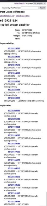

Amplifier Blown on my E89 30i 2010
Here are the other associated part numbers to look for (the ones that part superceded and the ones that superceded it).
You never know, might pop up cheaper
