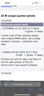

Someone on the BMW Car Club GB forum has listed a full set of new Coupe panels for sale
https://www.bmwccgbforum.co.uk/z4-m-cou ... html#88887

Much appreciated and that's a good find as I am in Sussex, too! I will pm him via that other forum.
