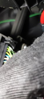

I have the fusebox down but cannot see how the long connector comes off as in this photo at the bottom.
Does that clip at the end push out towards the green wire in my photo, or do I need to pull it down / up, squeeze it?
Doesn't seem to budge in any direction.

Sussed it, it does push out towards the green wire. I used a bike chain split-link tool to push it out, gets a good grip on both sides.
Connected a wire to port 12 and other end to the 60amp fuse and the boot popped open.

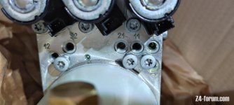

Thanks chippie, there are 6 hoses in each side, I really want to know which unit these all go to.

I assume, you have replaced the hydraulic pump by a used one?
You are talking about the rear roof panel?
Attention, in the following you'll see an updated list!
Hydraulic cylinder, Hose No.
roof shell, front right 23
roof shell, rear right 24
kinematics box, front right 33
kinematics box, rear right 34
main kinematics, front right 13
main kinematics, rear right 14
roof shell, front left 21
roof shell, rear left 22 kinematics box, front left 31
kinematics box, rear left 32 main kinematics, front left 11
main kinematics, rear left 12

Please apologize, my former list was wrong.
I've just checked it against a rather new hydraulic harness as well as against a set of hydraulic cylinders and found wrong orientations documented in my own excel sheet. It got updated in my former post.
