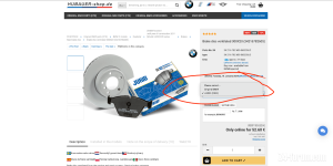

It time for new rear pads again, this time I thought I would change the discs as well. Been looking on this German BMW dealers website, they tend to have good price on genuine BMW parts. As you can see from the screenshot they are now doing OEM parts as well as genuine BMW:
Am I right in assuming OEM is exactly the same as genuine BMW but without the BMW logo stamped on the product or BMW packaging? The Jurid OEM are working out 40€ (for two) cheaper than the BMW ones and if so, I rather save 40€. I sent a query off to their customer support but the girl who replied was clueless.
Can anyone confirm if what I am thinking is correct?

If it’s OE quality then it means that BMW in the minds of the retailer MAY have chosen to source that product..amongst many others….
It is not the BMW part in a different box.
In some cases there is only one supplier of the BMW part and the OE part is identical except it has the BMW logo defaced / removed and is not in a bmw box.
Generally the European parts suppliers are pretty straight about what they are offering.
In many cases the BMW part is made to a spec which was good enough for BMW at the price they were willing to pay..in those cases you can buy a better quality product…eg Meyle HD product line..
It’s a pretty complicated minefield..
Then there are the pirated copies of things like NGK plugs..plus the obvious Chinese copies..

This stuff about BMW parts is all nonsense especially with consumables like brake parts. BMW don't make discs or pads, they buy them from third parties. They buy them from many third parties aswell, therefore at one time or another most makers will have been "OEM".Silverstar wrote: ↑Wed Jan 10, 2024 5:40 pm Am I right in assuming OEM is exactly the same as genuine BMW but without the BMW logo stamped on the product or BMW packaging? The Jurid OEM are working out 40€ (for two) cheaper than the BMW ones and if so, I rather save 40€. I sent a query off to their customer support but the girl who replied was clueless.
There is a rumour that the reason BMW branded discs rust and corrode so easily is that to save cost, BMW specify suppliers not to coat them in anything. Makes sense.
As long as they fit, it's a case of 'pay your money take your choice' IMO.
I have been very impressed by TRW discs and pads (another "OEM" for BMW/ Mini).
I have a new set of Brembo discs and Jurid pads in the garage but they haven't been fitted yet, so can't comment.

I use Hubauer regularly to buy parts and so far only have good experience with them.
Last year bought a set of Brembo discs and pads and can recommend that setup
BMW do produce brake discs themselves in Berlin. I have seen that with my own eyes. However they also use other suppliers as well

Hi Pondrew yes I am well aware parts are made by other manufactuers, the question I was asking here is are the Jurid discs being sold by this German BMW dealer original fitment parts i.e. where they fitted by BMW on the production line? Hubauer have indicated they are OEM, from what i've been able to gather is that they are manufacuters that at some point have supplied something to a car factory but not the actual manufacuters of the discs that BMW fitted in the factory. To be fair I have not had any corrosion or rusting issues with the originals but I am in sunny climes.

If it was a BMW part it would have BMW part number and manufacturing tracking codes.Silverstar wrote: ↑Wed Jan 10, 2024 11:05 pm Hi Pondrew yes I am well aware parts are made by other manufactuers, the question I was asking here is are the Jurid discs being sold by this German BMW dealer original fitment parts i.e. where they fitted by BMW on the production line? Hubauer have indicated they are OEM, from what i've been able to gather is that they are manufacuters that at some point have supplied something to a car factory but not the actual manufacuters of the discs that BMW fitted in the factory. To be fair I have not had any corrosion or rusting issues with the originals but I am in sunny climes.
Oilyfingers yes have to agree have used Hubauer in past also and as you say they have proven to be very good.
If you take a clear example…
On the N54 Pierburg make the turbo boost controller …
11747626350
Pressure converter
You can buy the BMW version…it is stamped with a BMW logo and has a bmw label…
If you peel the label you see the Pierburg logo.
So in this case the Pierburg part is OE quality but it’s not a BMW part..
You can buy a Febi Bilstein version…that’s not OE quality by association..it may or may not be equal to or worse or better than the BMW/pierburg
With something pretty low tech such as most brake discs it’s a commodity item…so probably ok to use…
A Chinese copy of a BMW index 12mm fuel injector is just a bad copy / re-used with fake markings..
If you buy from Autodoc etc yiu have a good quality supplier that will honour goods.
I’ve had Hella coils , Valeo sensors that were useless but they did honour refunds.
