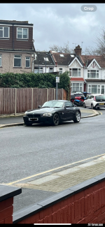

Hi everyone just wanted to let you know itโs finally sorted looking much better. But Iโve removed the foglights and lower valance as well as the kidney grills. I think it just looks much better and itโs disappointing the kidney grills are such a fiddle to get secure, I just decided to begone with them.

Keep the grills on mate, it looks like its waiting to go back and get finished.

Just got the fronts wheels put on this morning looking better now.
As for the grill , I use her for racing so the piece of plastic just seems a bit unnecessary and just another thing to replace.
