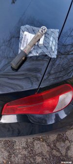

I use one of these 1/4 drive torque wrenches to get the right tightness. Body shops are usually good at aligning doors if the door alignment is out. Years of experience with convertibles have taught me the cheapest trick is to run some black sealant along the affected area, wait till it almost sets,
and then shut the door with a bit of Vaseline over the edge to get a good seal.- enuff_zed
