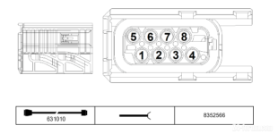

Does this help at all?
The top box is the Light Control Module.
E7 is the headlight itself.
X130 is the multiplug.
Looks like main beam signals through pin 8.

Ah ok thanks - will have a look. When you say light control module - is that same as control unit xenon light 631 269 07488?
2007 3.0si E86 Coupe - Carbon Black
- enuff_zed
- Posts: 14801
Retrofitlabs bi xenon upgrade advice
The rotary switch to the right of the steering wheel.
