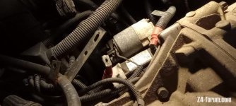

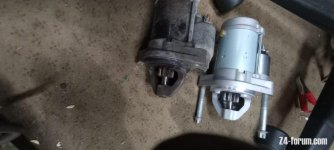

Had a 3.0l E85 in the Zedshed Cymru Shed today, starter motor had died but bump started to get it to the shed. Battery disconnected to begin then the starter cables removed. Access to the connections made from under the car having removed the underside alloy skid plate.
The Starter is quite buried so apart from the two retaining bolts being accessible from the top the unit has to be pulled out from below. The locating dowel on the bellhousing is a really tight fit and put up a fight to get it to release the motor. Fought back putting the replacement back in but managed to tighten the retaining bolts evenly to pull it back in. Reconnected the leads, reconnected the battery and gave it a first start, fired up first turn of the key. Oil and filter change followed and a full diagnostic scan using my Launch Tablet. A few codes cleared, will see if any come back after some driving cycles. Road test carried out and no codes appeared so far.

2.5 is easy from the top but the 3.0l M54 is buried under the inlet manifold so you can't see the terminal connections, these are accessible from underneath once the skid plate is removed.

Should have had a look at TIS before I started, just did a visual and decided to go in from underneath since it was on my lift and easy to get to once the skid plate was off using an Impact Gun on its 17mm bolts. Assorted spanners and sockets needed to extract the starter retaining bolts as space is limited at the firewall.
