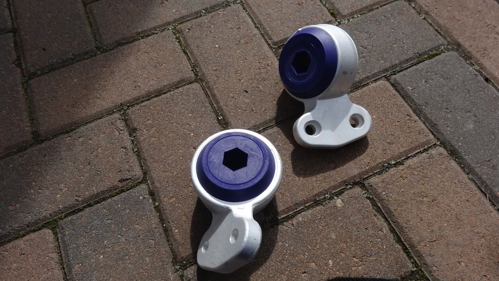

Had the car for around 4 months and have not been happy with the steering. Checked the movement front to back after jacking the car up and there was visible movement of the wheel front to back so I guessed bushings needed a change. Decided to go standard bushes on wishbones also Anti roll bar (ARB) bushes looked tired so ordered some poly bushes for the ARB.

The new bush versus what was left of the old bush!
The bare wishbone, alloy hexagonal.
TOP TIP: Fitting the new bush Use washing up detergent as a lubricant for the rubber bush. This allows correct positioning. Grease or WD40 did not seem to work.
Bolt every thing back up.
I have repeated the exercise by fitting Poly bushes today. In comparison to the first time this was a breeze and the old lollipops came off easily . I used a 3 leg puller to help.
What a difference in the cars handling the old bushes were clearly knackered. They didn't last long!
