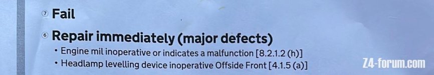

There seems to be some knowledgeable people on this thread hope you don’t mind me popping in with a related but different question.
Just had an MOT fail due to “headlamp levelling device inoperative offside front” as in pic. Other issue sorted.
Anybody know;
- where to find the sensor?
- what might be causing that?
- is it a fix I can do myself? (intermediate tinkerer)
- what might a garage repair cost?
Thanks in advance legends
