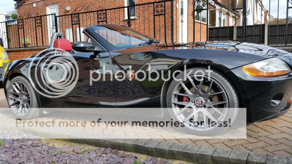

Mine are 18's 8.5 front 9.5 rears with et 35 front and rear.Crabbo wrote:Hi everyone as above,
I like the look of 19's but am concerned that the uk roads are terrible.
Has anyone got any pics of 18x8.5 and 18x9.5?
Preferable csl reps?
And tire sizes for this size wheel that will not scrub ?
Thanks in advance
Rear tyres off hand are 255/35/18 and fronts 225/40/18

They look pretty good have you lowered it as well?
