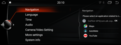

So I had a faulty wiring harness hence sound from only the left speaker, another problem I’ve found is when using the Idrive controller when navigating the android unit it still controls the bmw menus even tho you’re on the android screen not sure if I’ve got the settings right though
mwhite88 said:
.....another problem I’ve found is when using the Idrive controller when navigating the android unit it still controls the bmw menus even tho you’re on the android screen not sure if I’ve got the settings right though
Can you elaborate a little more, exactly how and in doing what? I can't say I can give you a definitive answer but I'll try.
Have you checked the settings screenshots on page 8 of this thread? Just to compare them to what you have!
So I had idrive already in my car, say I have it on split screen mode with the map, I go into the android mode holding down the menu button then I use the Idrive controller to navigate the menus and open apps etc, when I hold menu again and return to the original bmw mode split screens gone and it’s been navigating in the original mode also
